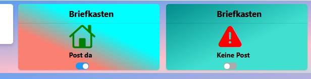

and it looks like:
but no Blinking/Flashing, when the postbox is filled.

This is a subtle one. In fact, your CSS looks like it should be correct. The problem is with your oh-icon. That’s actually one of the few components that doesn’t pass the class property on to the underlying html elements. So, your icon is just never getting the blink-active class.
The quick solution here is just to wrap your icon in a div element and apply the class to that instead:
  default:
    - component: div
        class: '=(items[props.dummy].state === "ON") ? "blink-active" : ""'
        default:
          - component: oh-icon
              action: command
              actionCommand: "false"
              ...rest of config
Many thx for your solution. Now the widget works fine.
I have read about that “div”-element in other threads of you, but didn’t understand, as sometimes I’m a bit stupid :zany_face: to understand (as I’m 72 :old_man: ). But with your personal tip I brought the widget to do do what I want.
