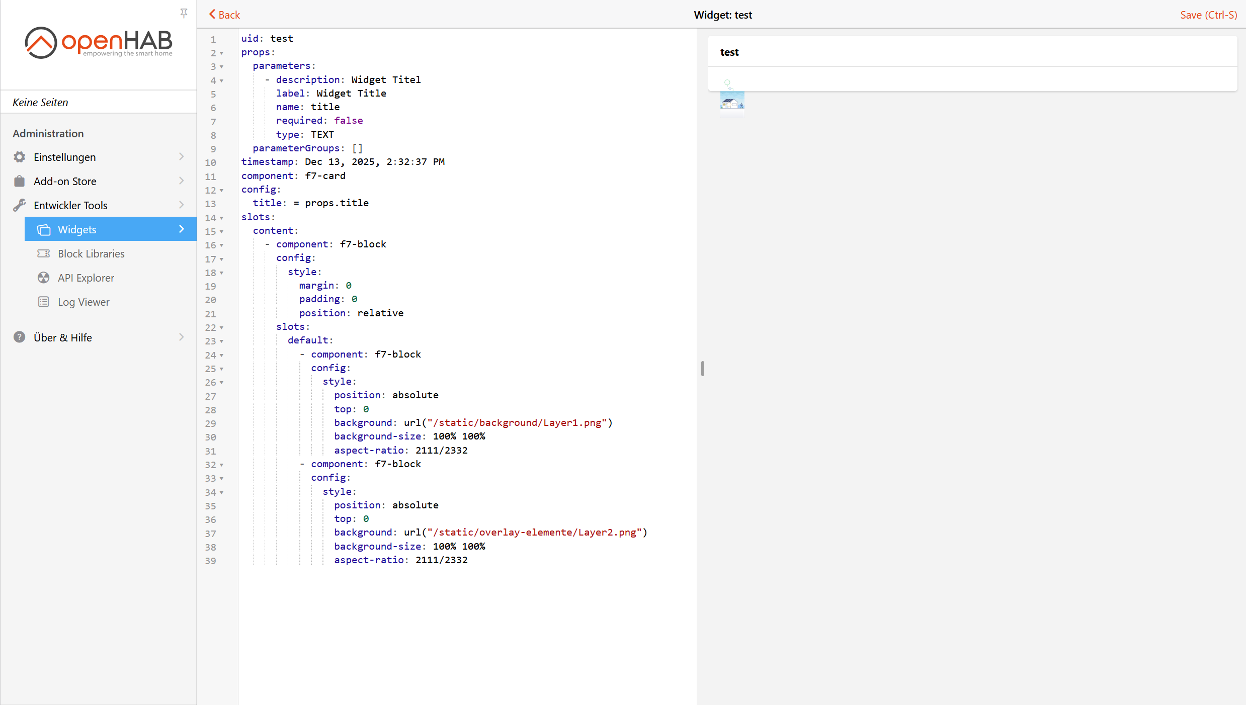

Here is my new code:
uid: test
props:
  parameters:
    - description: Widget Titel
      label: Widget Title
      required: false
      type: TEXT
  parameterGroups: []
timestamp: Dec 13, 2025, 2:32:37 PM
component: f7-card
  title: = props.title
  content:
    - component: f7-block
        style:
          margin: 0
          padding: 0
          position: relative
        content:
              style:
                position: absolute
                top: 0
                background-image: url("/static/background/Layer1")
                background-size: 100% 100%
                aspect-ratio: 2111/2332
              style:
                position: absolute
                top: 0
                background-image: url("/static/overlay-elemente/Layer2")
A block does not have a content slot. Use default instead.
Right, my fault.
Nevertheless, it is not functioning.
Now I am able to see an image.
Unfortunately, they are now very small and again below each other.
uid: test
props:
  parameters:
      label: Widget Title
      required: false
      type: TEXT
  parameterGroups: []
component: f7-card
  content:
        style:
          margin: 0
          padding: 0
          position: relative
        default:
              style:
                position: absolute
                top: 0
                background: url("/static/background/Layer1.png")
              style:
                position: absolute
                top: 0
                background: url("/static/overlay-elemente/Layer2.png")
This is the downside to using this method. Once you give the element a position: absolute it is removed from the chain of size calculations so, at the moment there is nothing giving any of your elements any specific size. The only reason you see anything at all (i.e., that the blocks are not 0 x 0 in total size) is that you are using f7-blocks which have a padding value. You will have to give your image containing elements some explicit size. There are probably other styles you will have to tweak as well because you are using f7-blocks for this. I would say you would be much better off using oh-image components for this, but you have indicated that the f7-block is somehow important, although I don’t know why. If you have to have a containing element like that you are probably better off using div component instead which will have no additional styles that you do not explicitly add.
