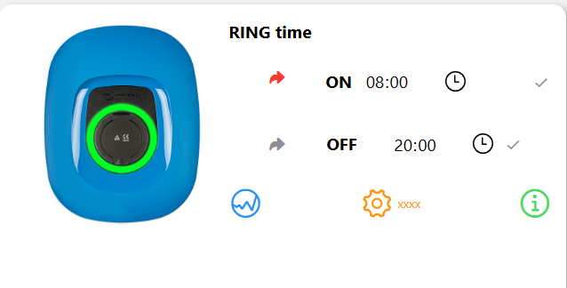

Widget with time input
I have a widget where I want set a ON and OFF time :
problem is, that on the cell phone screen clock is missing :
question is, if this is really correct way how to input a time
Here is my code:

The clock button is not a function of OH, it is a function of the html input tag itself. Are you viewing the mobile version on an iPhone? I believe that Safari treats the time input differently than many other browsers.
No it’s android phone. Is this right way for time input or is any other way for time input in the widget ?
There are other less direct ways, but this is the way I would use.
