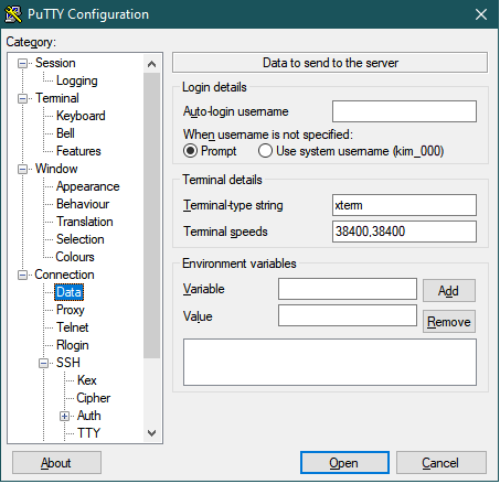

Regarding username in putty, it´s a setting you can change. Notice its either manually entered, promtet or use windows username (system username):
