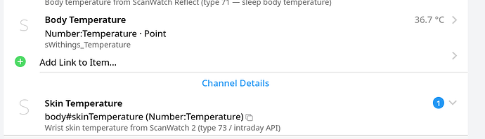

body#temperature now shows 36.7°C !

no problems found so far
  1. The body#temperature is updated as expected.
  2. The body#skinTemperature stays at NULL, but I think this is to be expected (for ScanWatch2)?
  3. The sleep#sleepSkinTemperature stays at NULL, to be expected for ScanWatch2?

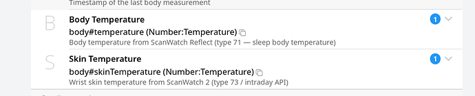

  1. You might want to check the sleep_efficiency value, it seems as if OpenHAB receives a float (0..1), but your documentation suggests it should be normalized to percentage (0..100)?

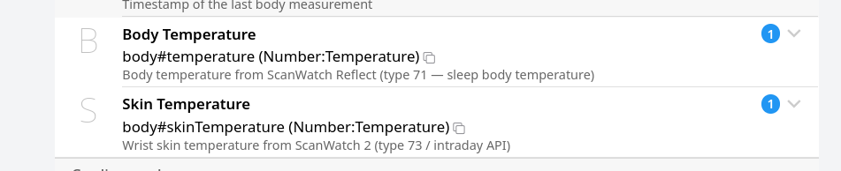

  2. In the MainUI, the footer text for body temperature and skin temperature are probably too technical?
