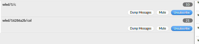

I seem to be missing something here its using the latest wled firmware the top if from setting the colour from the android app which works he lower from plugin
do I need a transformation of some kind ?
thanks
Arden
no transforms nor maps needed, the binding does it all, just see the readme file.
seem the plugin isn’t compatible with the version 9 firmware
have flashed 8.5 and working.
edit
seems if you add using a 8.5 them upgrade to 9 it works but direct to 9 doesn’t confirmed with 2 esp8266

Interesting, did you happen to get any MQTT dumps of when it was not working compared to working? It would be good to report this to the firmwares issue list at GitHub if you can explain what caused it to not work.
FYI, I installed 0.8.6 on a brand new D1 mini clone and it worked, then I upgraded to 0.90-b1 and it works still just with the main difference being the FX list is different between the two versions. I would use the 0.90-b1 because the UI is completely different and no point learning an old UI.
