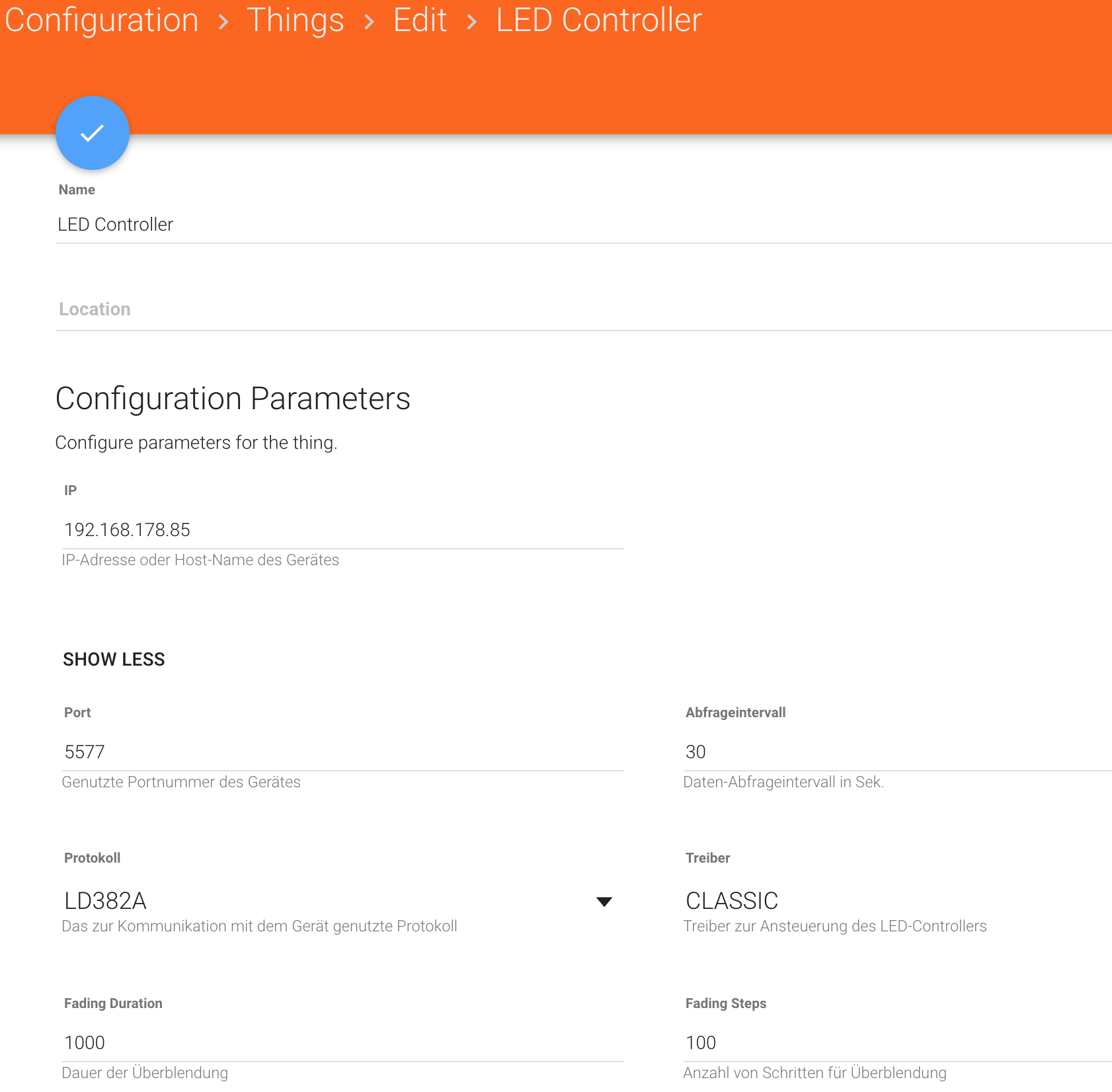

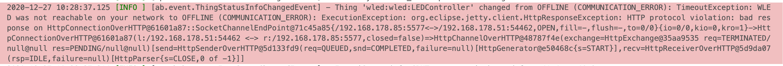

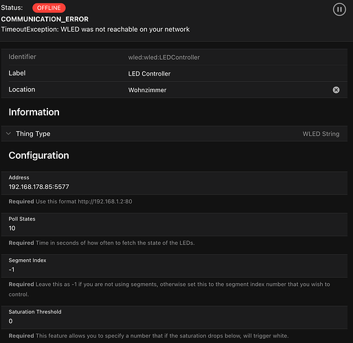

I’m trying to move my setup from OH2 to OH3 (latest snapshot). I have a working LED controller using the WLED binding. The binding is added to the OH3 configuration. The LED controller gets discovered as a thing but when I add the same configuration parameters as in OH2 I get the following error:
My configuration on OH2 looks like this:
In OH3 I have set the parameters as follows:
and the thing remains offline with the error message.
Any idea what I can do to solve the issue?

The oh2 picture shows the wifiled binding, that is a different binding.
pune2001
(Pune2001)
December 28, 2020, 10:14pm
6
Yes, indeed. Dumb mistake. I changed the binding - and now it works in OH3 as well.
