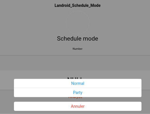

Does anybody know how to activate the “party mode”?
Party mode simply tells the mower not to mow for the time where the party mode switch is set to on.
String Worx_ScheduleMode "Mähmodus [%s]" {channel="worxlandroid:mower:mower:m500plus:schedule#mode"}
Worx_ScheduleMode.sendCommand("1") //normal mode
Worx_ScheduleMode.sendCommand("2") //party mode
This must be put into a rule, right?
or where must it go?
Correct
It should also work in UI :
