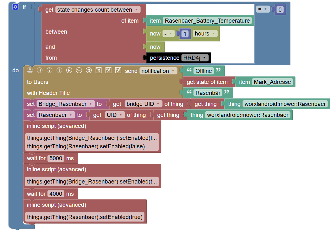

I also have the problem described here. My work around is that I disable the Bridge and the Thing shortly before the actual start of mowing and then reactivate them one after the other.
I check whether the mower is online or offline via the battery temperature; if it hasn’t changed in the last hour, then I assume that the Bridge and/or Thing are offline.
var Bridge_Rasenbaer, Rasenbaer;
var thread = Java.type(‘java.lang.Thread’)
if ((items.getItem(‘Rasenbaer_Battery_Temperature’).persistence.countStateChangesBetween(time.ZonedDateTime.now().minusHours(1) ,time.ZonedDateTime.now(), ‘rrd4j’)) == 0) {
actions.notificationBuilder(‘Offline’).addUserId(…items.getItem(‘Mark_Adresse’).state.split(‘,’)).withTitle(‘Rasenbär’).send()
Bridge_Rasenbaer = things.getThing(‘worxlandroid:mower:Rasenbaer’).bridgeUID;
Rasenbaer = things.getThing(‘worxlandroid:mower:Rasenbaer’).uid;
things.getThing(Bridge_Rasenbaer).setEnabled(false);
things.getThing(Rasenbaer).setEnabled(false)
thread.sleep(5000);
things.getThing(Bridge_Rasenbaer).setEnabled(true);
thread.sleep(4000);
things.getThing(Rasenbaer).setEnabled(true)
Certainly not optimal, but at least this way I can continue to control the mower.

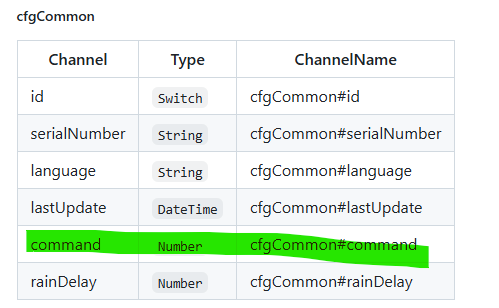

hello! What does following command do?
I could not find it in the documentation.
I think (but never tried it) you can send commands as numbers to the mower:
1→Start
2→Stop
3→Home
4→Pause
Please tell us when you have find that out :grinning_face:
