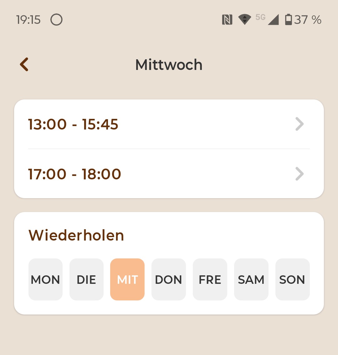

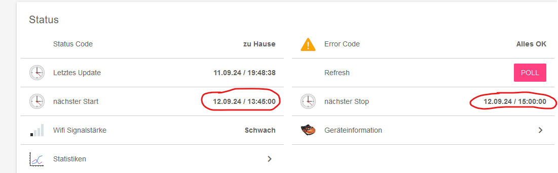

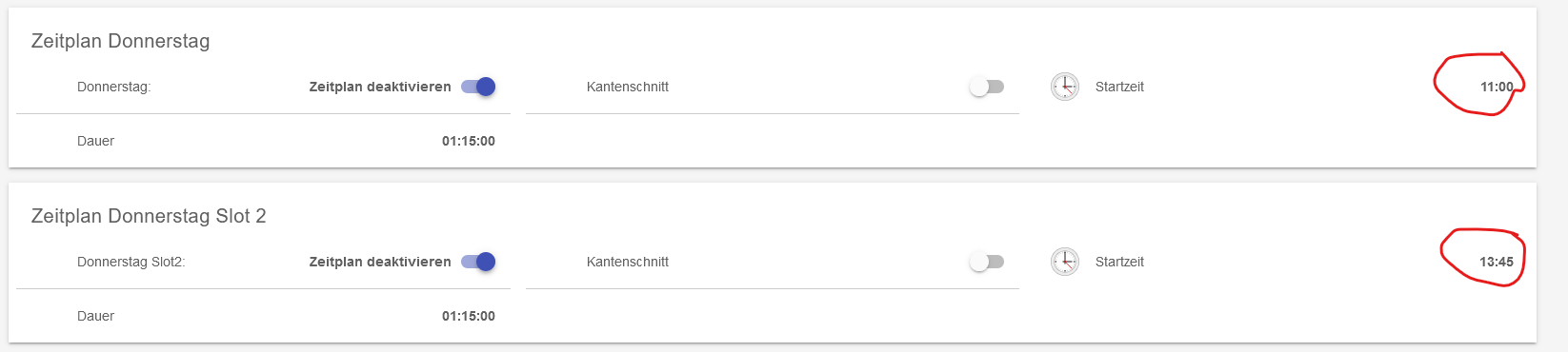

I would like to bring up my issue with the second schedule again.
As a result, the next start and next stop are also incorrect

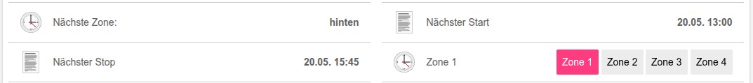

Are you talking about Channels schedule#next-start and schedule#next-stop?
Those work fine in the official, now merged binding and are showing the correct time.
Note that you need a recent snapshot of openHAB to get rid of the above mentionend error.
Edit: Ah, you are talking about more than one timeslot. Can’t verify, I only have one time slot per day. If I have a lot of spare time, I will try to check that out …
Okay, I had a lot of sparetime now :smiley:: as I already assumed above, the times are correct:

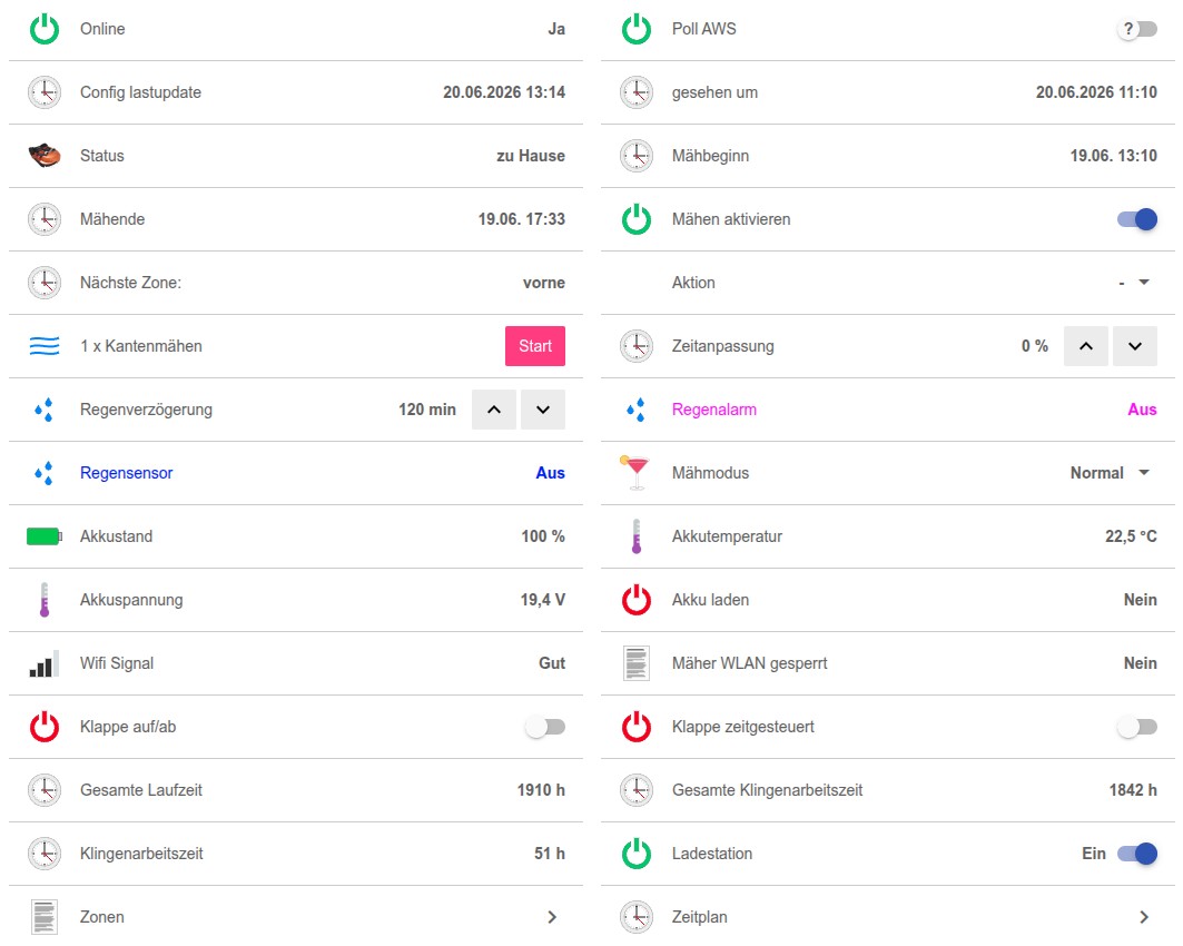

While commandIn is dead, none of the usual “is it connected” signals are reliable:
  • Thing status still reports ONLINE (false positive).
  • The aws#connected channel does not reflect the real send state.
  • The status channel freezes on its last value instead of going stale/UNDEF.
The only reliable “live” signal I found is data freshness: the config#timestamp channel advancing. If that timestamp stops moving, outbound commands fail – regardless of what Thing status / aws#connected report.
