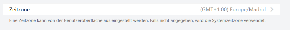

And setting in OH
However, I not only see that the logfile is one hour behind (i.e. as set to “UTC”), also the cron triggers are using this “wrong” time. So it looks as OH is not taking the TZ into account.
