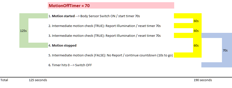

I’ve now run some tests and here are my results. I think it must work like this but I’m still not 100% sure. So please correct me if I am wrong.
According to my tests the MotionOffTimer should be set to a value higher than 60s (whenever a motion check is performed). Every 60s a check is performed and if motion is dectected, the motionofftimer will be reset and starts from new. At the same time (if motion is detected) illumination is reported. See attached chart.

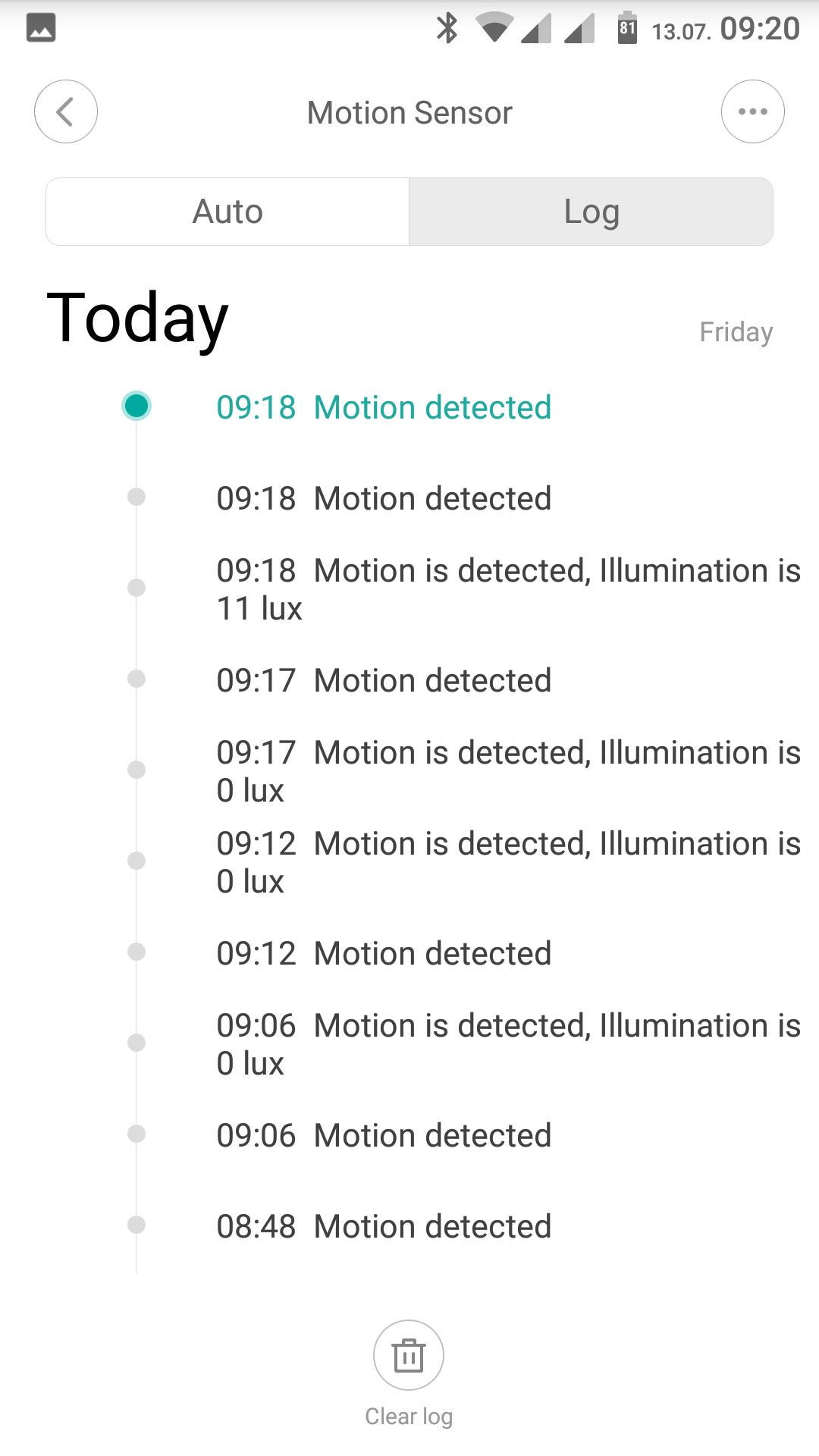

took me a while but just now I had the idea “let’s check the original xiaomi smartphone app” and unfortunately it shows exactly the same information so it’s not an openHAB issue but maybe sensor or gateway issue.
in the app I can check the device log and here I see for example:

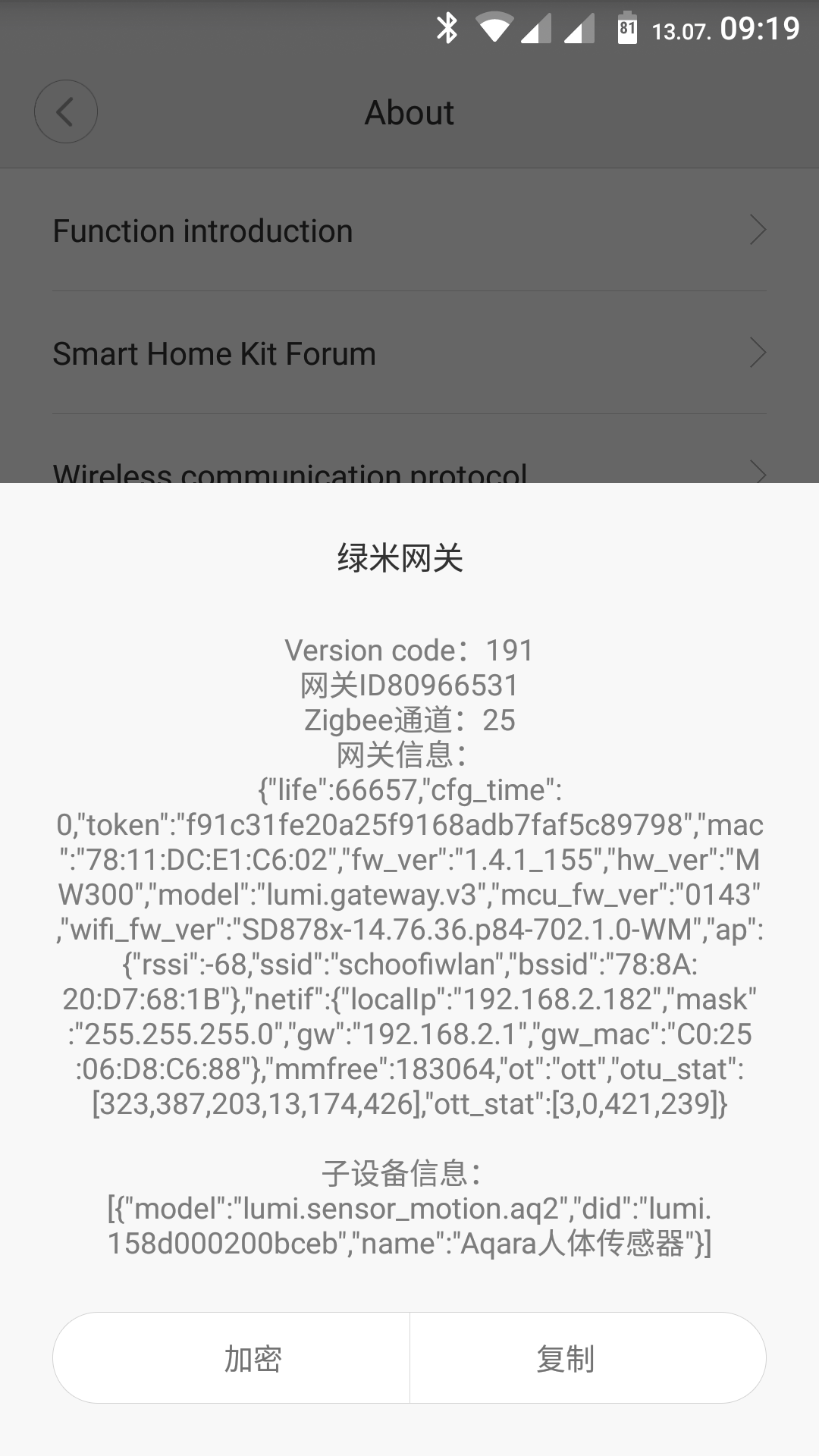

Below are two screenshots from my smartphone (xiaomi app). Your help is highly appreciated!
Seems to me openHAB is doing nothing wrong. Even the original app displays this weird data.
