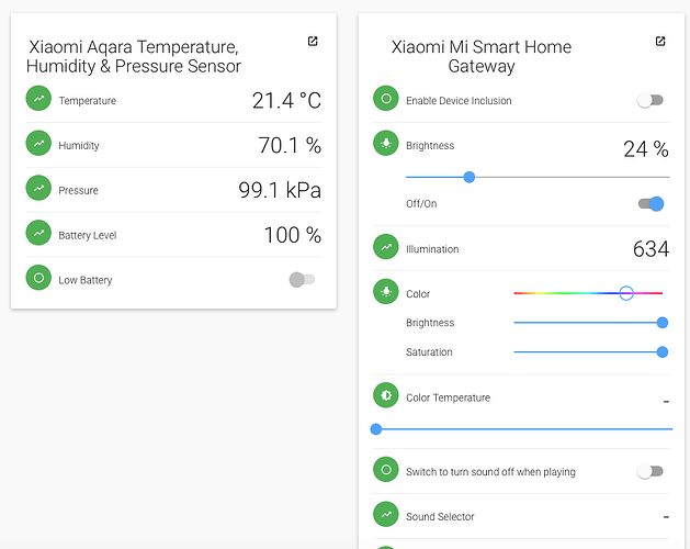

I attach to this what I’m facing, I’ve included the binding with the gateway and also the sensors but it looks there is a updating problem being that the values I want to control are not working and by the mi app everything works but through openhab I cannot control anything.

For temperature sensor, It looks it’s working but for gateway I cannot arm/disarm or turn on/off light or changing colors and it’s happening the same with motion not shown on screen.
By the way I don’t know if it is normal but sometimes when I exit from control web and after I come back the xiaomi things are not there and I need to disable/enable some property like brightness to make it appears again in control web.
If the temperature senor shows data, communication with the gateway is fine.

Let’s start with an easy example, the light.
I notice that you set the color temperature fully to the left; did you try setting it in the middel (it might not give light output when set completely to the left)
