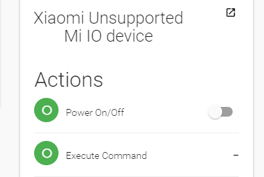

Wonderful. So this works when running from the “Execute Command” for the remote in PaperUI. For anyone that is struggling, this is the rest of my setup. I used the on/off for my aircon for this example.
Items
Switch ac_power (AC)
String ac_power_string { channel=‘miio:unsupported:03EE3156:actions#commands’ }
Sitemap
	Frame label="Air conditioner" {
		Switch item=ac_power icon="heating"

I have created a string item linked to the IR remote Execute Command Action in Paper UI but there is no input box for commands.
Can someone help?
As this is an unsupported item you will have to get each command code and then send these codes to your Remote using a rule.

Now to get back to OpenHAB. I will assume you created a item linked to your IR Remote. It should look something like this:
String IRRemoteCommand { channel=‘miio:unsupported:01SF1563:actions#commands’ }
