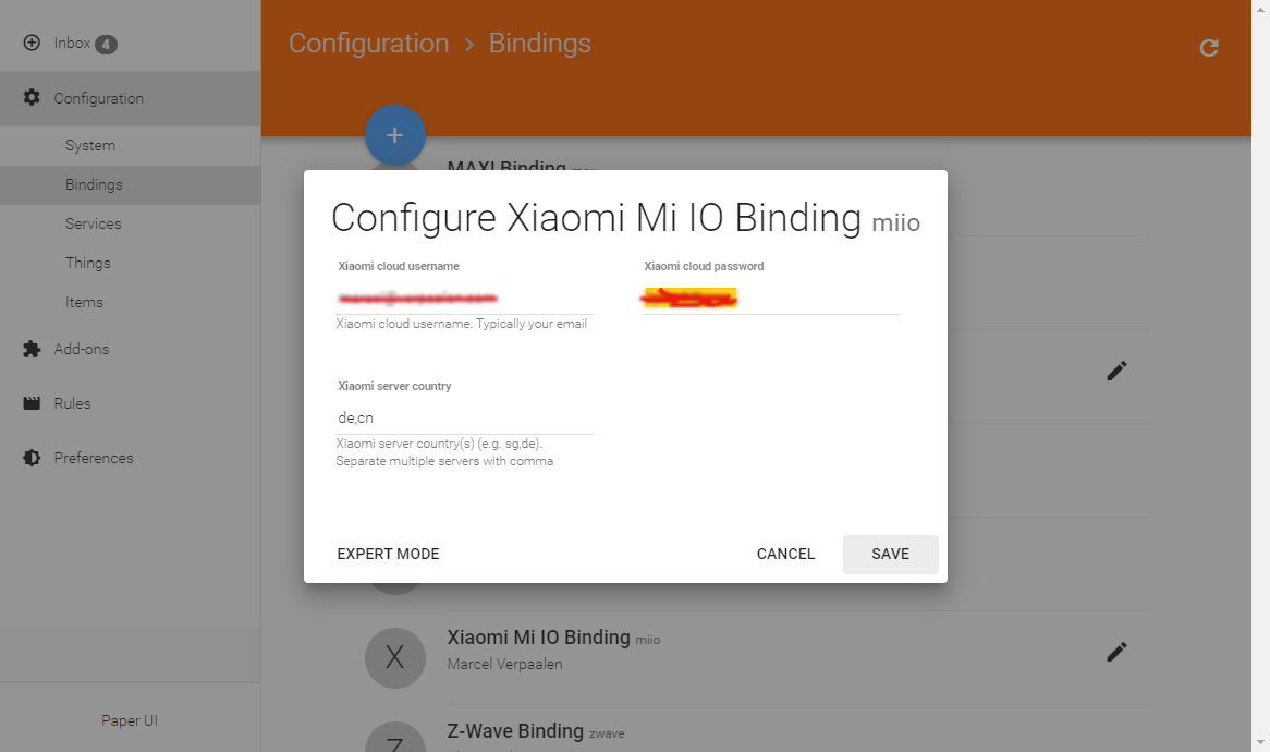

  • The device info is currently only retrieved from the cloud at logon if you add a device or reset it, you need to logon again. The simplest way (without restarting the binding) is to change e.g. the county string.
  • Country in the config is pointing to the various cloud servers. I think the following servers exist: ru,us,tw,sg,cn,de leaving it blank will try all these servers.
  • In your (vacuum) thing you can configure the server related to your vacuum.

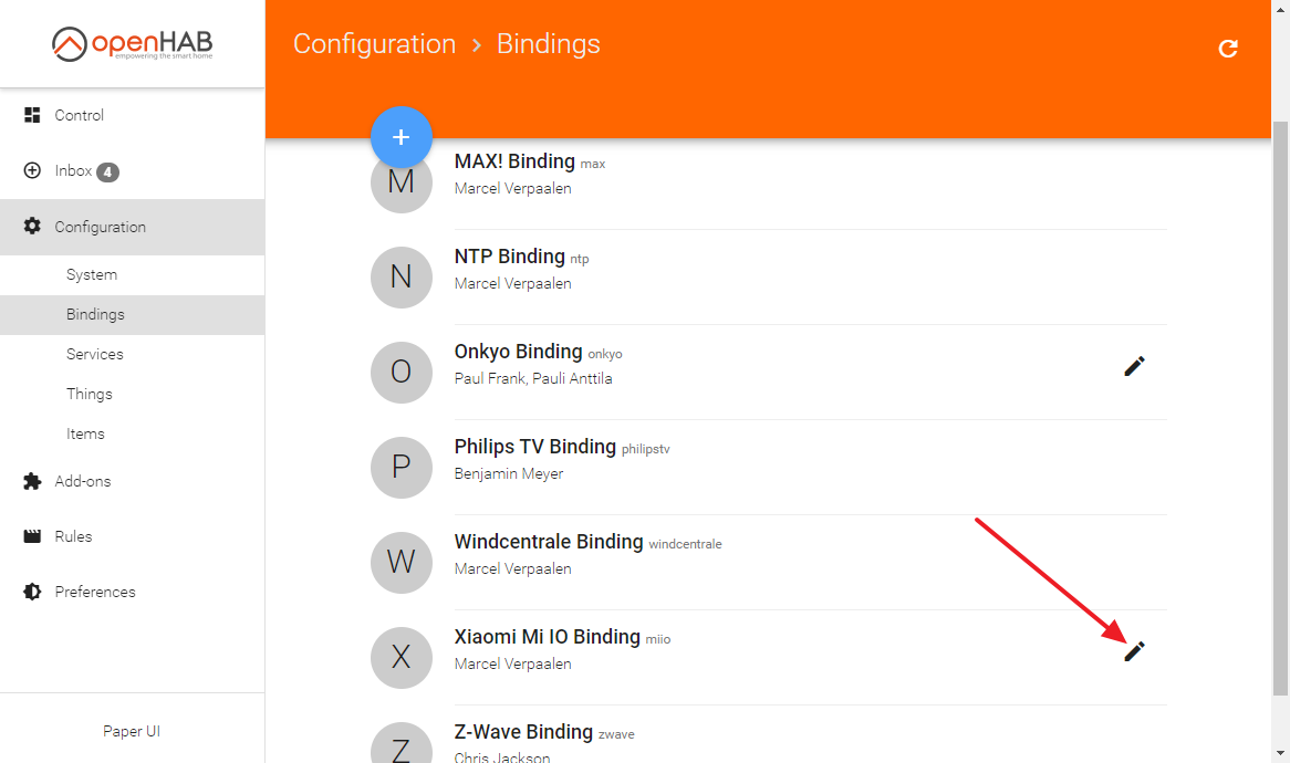

To configure the cloud connection
