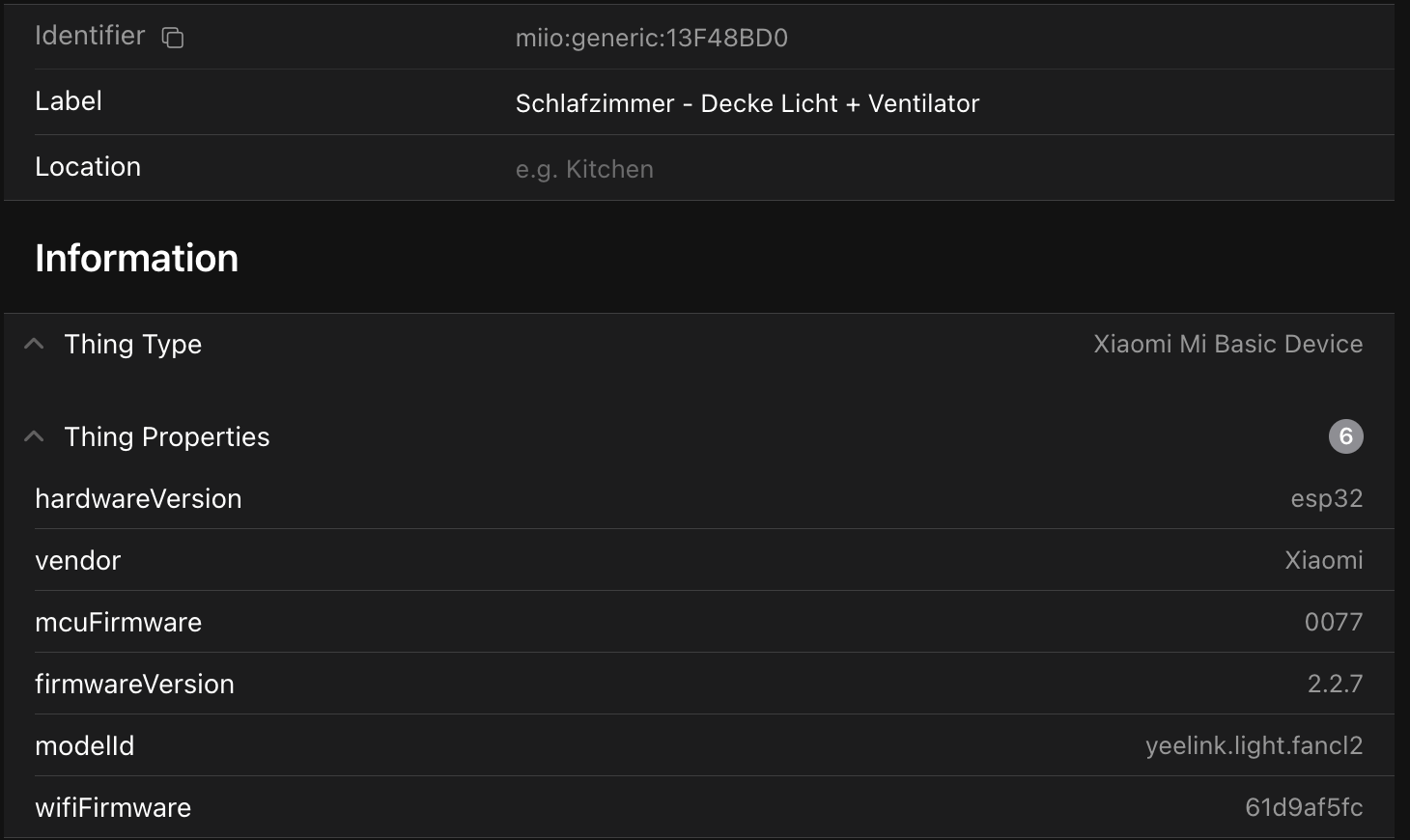

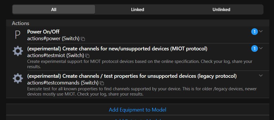

I have a new yeelight ceiling lamp which has also an integrated fan. I add it via web interface and it identifies as:

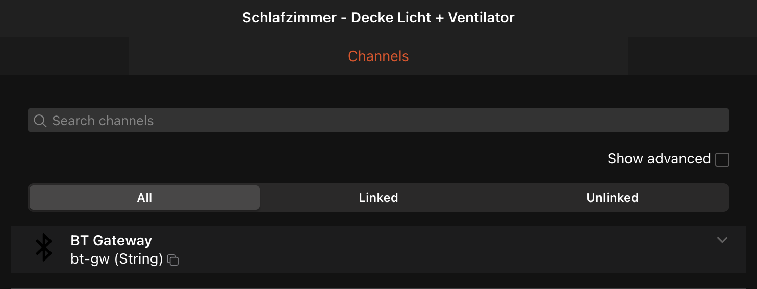

I wanted to add the channels via the experimental switch but I just have one channel:
How to proceed? If I remember correctly I could add it in openhab 3 but after a fresh install of openhab 4 it doesn’t seem to work anymore.
If I try to change the type it gives me a not allowed error message.

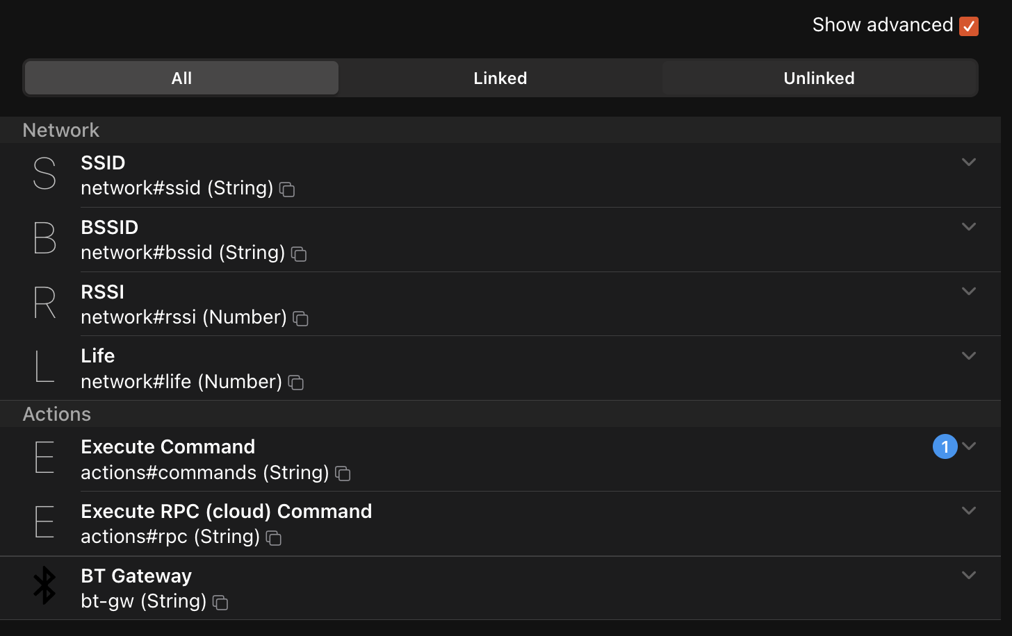

edit:
show advanced turned on:
