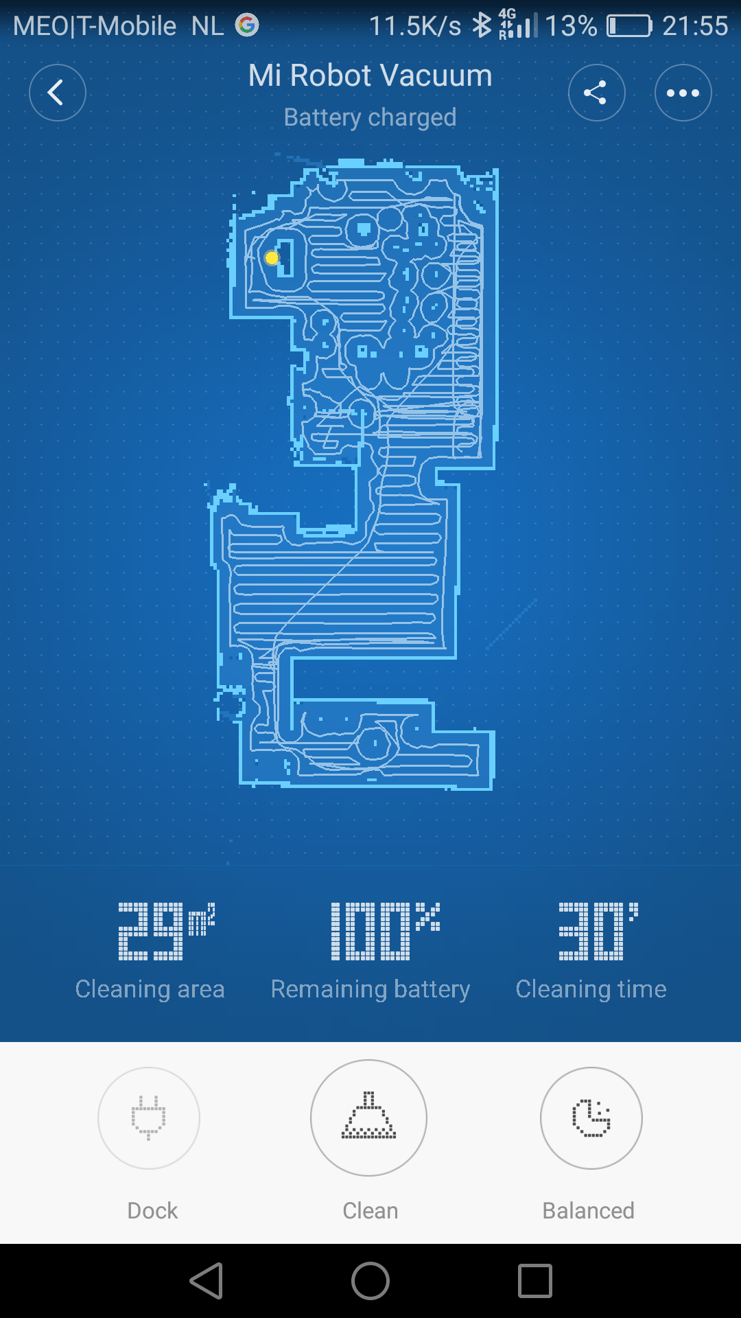

This is how it looks for me in the Mi app.
The buttons in the bottom operate the vacuum.
For openhab you need to extract the tolken from the app as described in the first post
and that’s not how it looks for me. :frowning:

Okay, so the screen I showed is after I click the vacuum icon on the screen you showed .
If it does not being you to the screen I showed, maybe something went wrong with downloading the plugin. I would uninstall and reinstall the app.

Thanks Marcel. Nothing happens when i click on the vacuum icon, and i’ve installed on two different devices and it’s been like that. I guess i can only try again.
