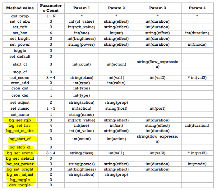

After having another look at the yeelight API document I found the culprit:
This sort of light has another set of functions which control the ambient ligth and color (bg = background in yeelight’s terms). And since @marcel_verpaalen’s original does’nt seem support these yet I used the fallback ExecuteCommand method from his binding to achieve my main goal…
This is my rules section (I control the lamp with an aqqara double switch):
rule "Xiaomi Aqara Battery Powered 2 Button Switch"
    Channel "mihome:86sw2:158d0001e06500:ch1" triggered SHORT_PRESSED
    YeelightKChe_Actions_ExecuteCommand.sendCommand('dev_toggle')
    Channel "mihome:86sw2:158d0001e06500:ch2" triggered SHORT_PRESSED
    YeelightKChe_Actions_ExecuteCommand.sendCommand('set_adjust["circle","bright"]')
    Channel "mihome:86sw2:158d0001e06500:dual_ch" triggered SHORT_PRESSED
   YeelightKChe_Actions_ExecuteCommand.sendCommand('bg_set_adjust["circle","color"]')
@marcel_verpaalen: Did you ever tried dynamic Channel creation upon discovery? My suggestion would be to implement all these functions from the screenshot above generically and then pick just the supported ones (see bold line below) when the thing gets created? Might this be possible? I’d be more than willing to lend a hand…
