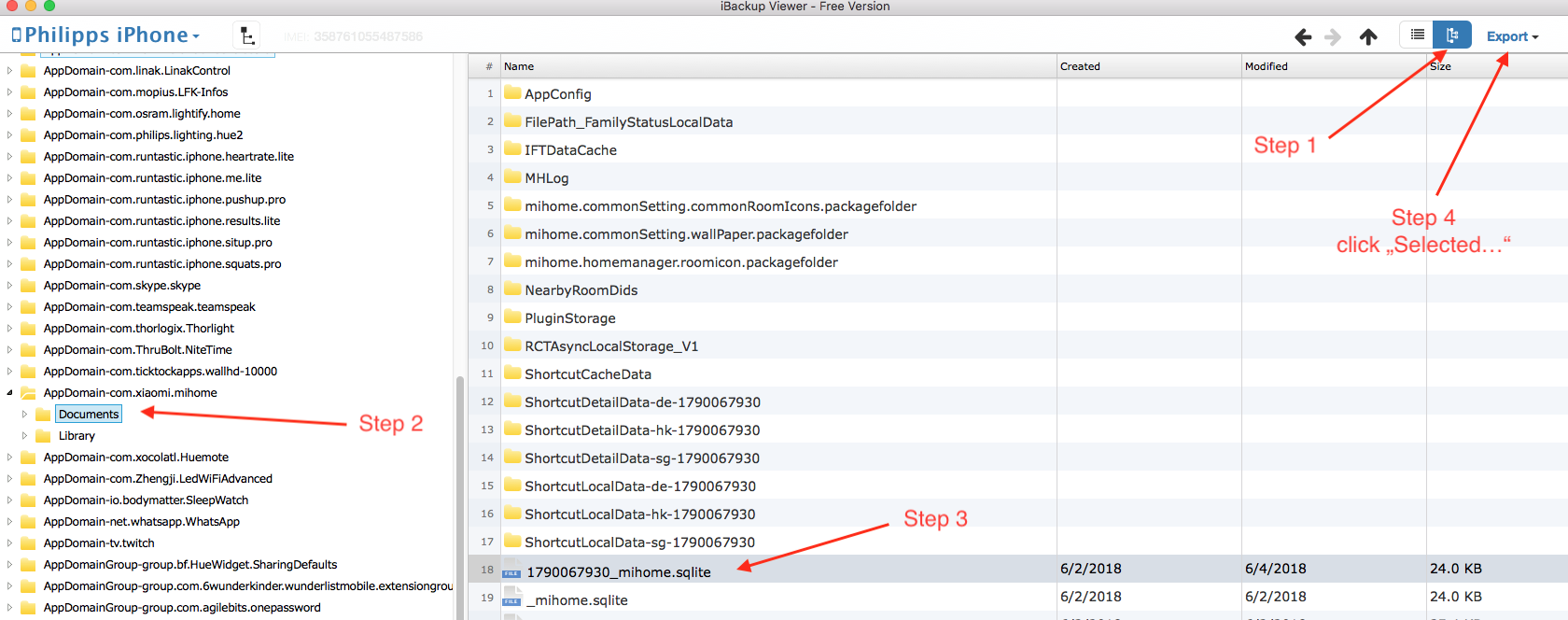

while waiting - the iBackup Viewer for the TOKEN looks a bit different in the newer version
here is a screenshot on
how to get the token (you dont need an unencrypted backup - works with both)
EDIT:
i watched the youtube video 2 posts before - this helped me out - thanks @Nico111

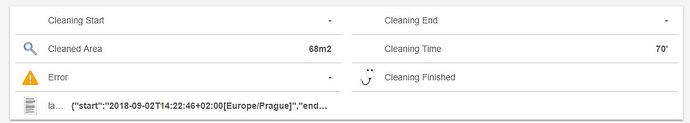

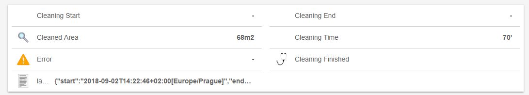

One set of strings do not work with my V2 Roborock. They all are related to the last cleaning (all .items & .sitemap more or less copy&paste of the code from the forum here). Is it only due to v2 robot?
See how it looks:

Looks like it. Can you send me the debug log so I can see the full conversation and responses.
Let me know the one that works best, and your original model and I add it to the database
