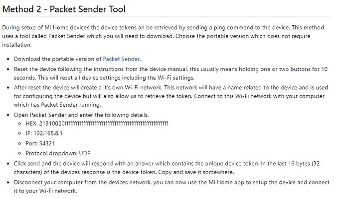

Hi, I extracted the token from my Xiaomi Roborock S50 in this way:
After getting the token I tryed to set the token inside the openHAB page. In the first time it seems working but after two minutes from ONLINE the message become OFFLINE - CONFIGURATION_ERROR. How can I fix this?
Thank you in advance.
@Giovanni_GuadagniniActually you could have used OH to get the token that way. It will do it for you.
However, this method is not really useful anymore for most devices. The token will change as soon as you connect it to the regular network with the app.
The best way to get the token in Android is to use either the hacked mihome app, or downgrade to old version and pull it from the app database. Or use the IOS app database.
How can i do it?
Hello Giovanni,
look at this Youtube Video. The only problem is that the video is in german.
