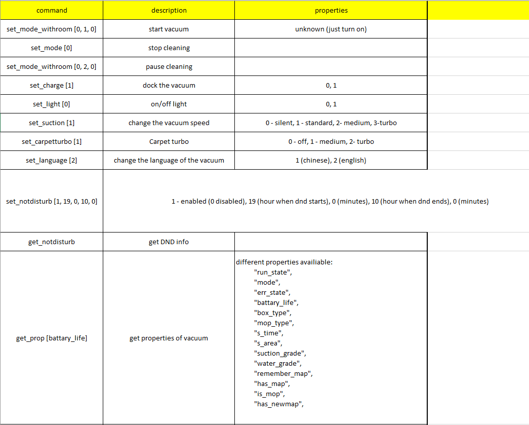

got most of the commands up and running for viomi-vacuum-v7, I still need to figure out how to change the water level used by the vacuum, but most of them are already there.
@merccooper if that is all, you can make a basic device database entry to (almost fully) support it.
Only the get_disturb would be trickey
Look at the existing database files, gives you direction on how to do. All the things you find in the get_prop section should have a corresponding property in the database.
The actions are to send the set_… commands

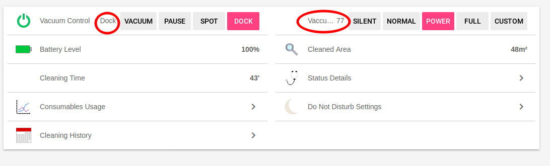

Hello, I have two questions about this binding. The first is a problem with visualizing the fan and control elements for the 1st version of the Vacuum:
Thats my items:
String actionControl  "Vacuum Control"          {channel="miio:vacuum:67f48725:actions#control" }
Number actionFan      "Vacuum Fan"         (gVac)   {channel="miio:vacuum:67f48725:actions#fan" }
Thats in my sitemap:
Switch item=actionControl mappings=[vacuum="Vacuum", pause="Pause",spot="Spot", dock="Dock"]
Switch item=actionFan mappings=[38="Silent", 60="Normal", 77="Power",90="Full", -1="Custom"]
I copied it from some examples here and it should work. I am using OH2 v2.5.
