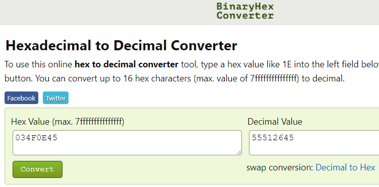

See below screenie: So with the new version you need the 55512645 as deviceId whereas in the old version it would have been the 034F0E45
If you don’t see the number anymore you can use e.g. : Hexadecimal to Decimal Converter to convert it or e.g. the windows calulator.
let me know if indeed you had text config and/or if this worked out for you.

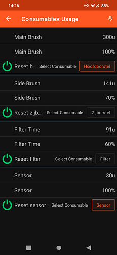

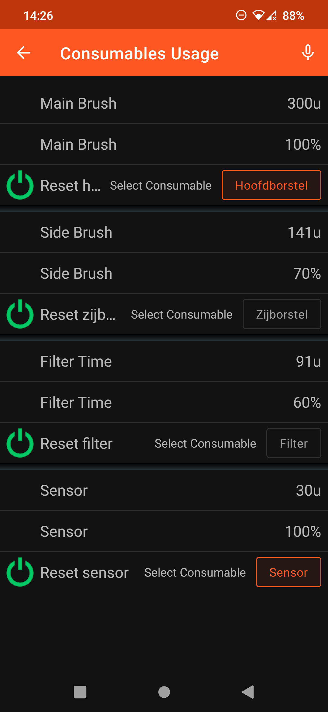

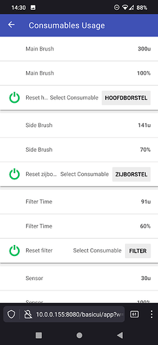

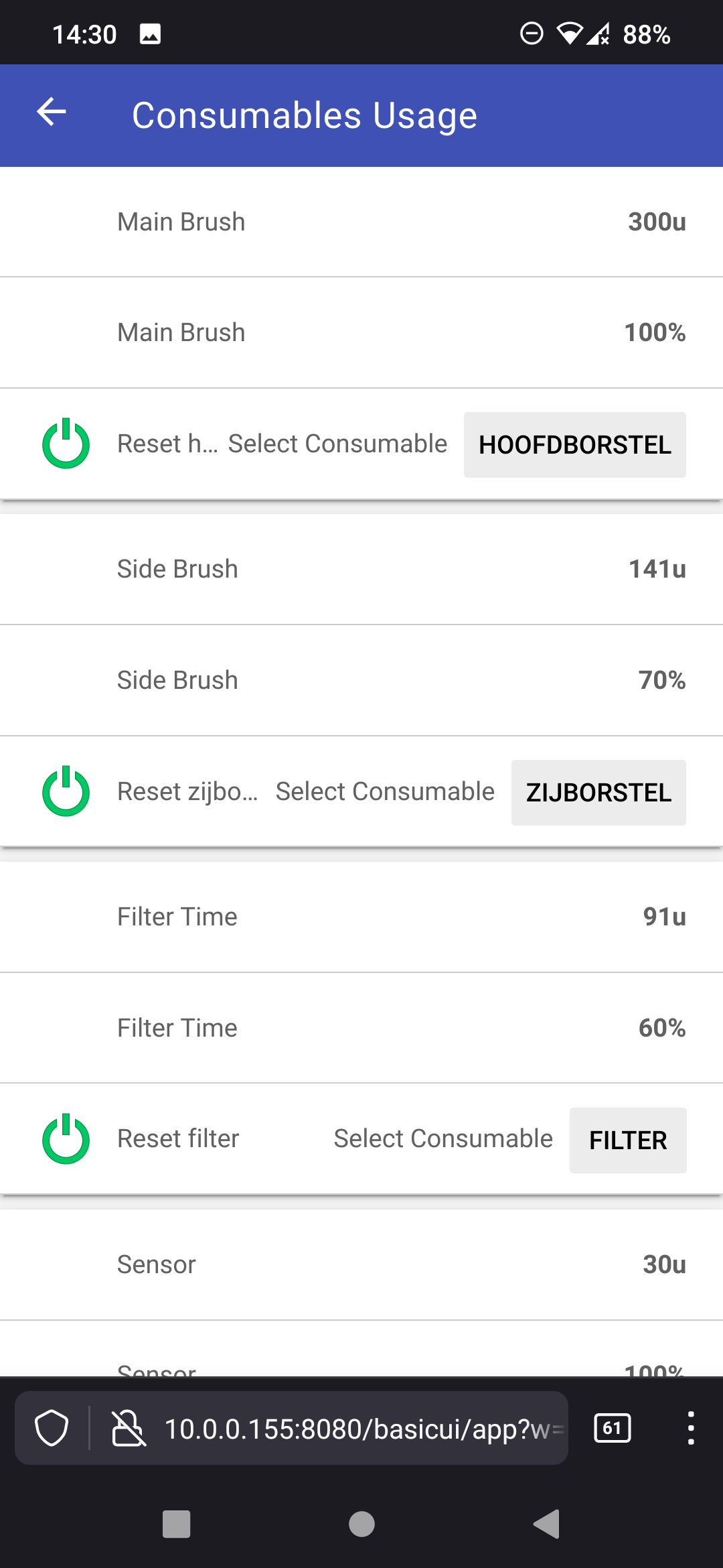

Is it possible to hide “Select consumable” on the sitemap (basicui and OH app)?
