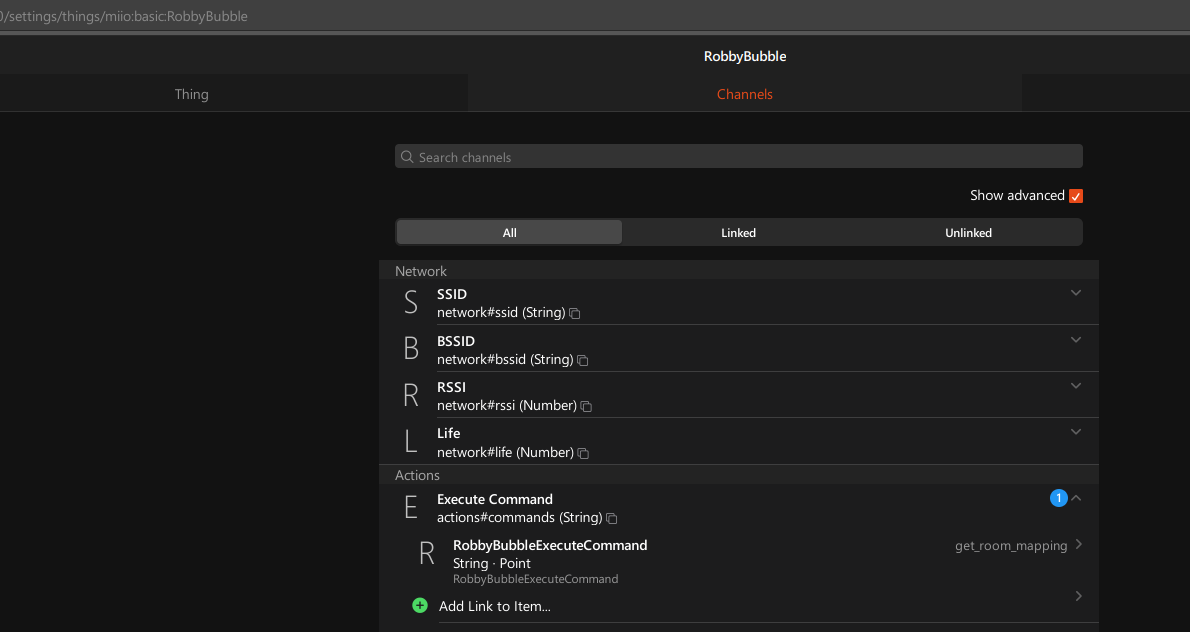

You can send the command get_room_mapping to the command channel.
It will then show you in the log the different available rooms defined in the Xiaomi app.
You can then send the rooms to the command channel to identify which number is which room.

about get_room_mapping i sent it to the command channel but i get
2021-12-28 13:45:04.732 [INFO ] [openhab.event.ItemCommandEvent      ] - Item 'MiRobotVacuumV2_Actions_ExecuteCommand' received command get_room_mapping
2021-12-28 13:45:04.742 [INFO ] [penhab.event.ItemStatePredictedEvent] - Item 'MiRobotVacuumV2_Actions_ExecuteCommand' predicted to become get_room_mapping
2021-12-28 13:45:04.750 [INFO ] [openhab.event.ItemStateChangedEvent ] - Item 'MiRobotVacuumV2_Actions_ExecuteCommand' changed from {"result":["ok"],"id":14577} to get_room_mapping
2021-12-28 13:45:04.785 [INFO ] [openhab.event.ItemStateChangedEvent ] - Item 'MiRobotVacuumV2_Actions_ExecuteCommand' changed from get_room_mapping to {"result":[],"id":12567}
maybe my roborock S5 doent support it?
It is because the command itself does not return anything directly.
Check your log/ the channel a few seconds later and you find the response
I got a S5 (Max) as well.

@Wikibear your device does not support the command. It is a completely different device command wise from the viomi/rockrobo devices
Your device is a ‘miot’ device, having different command structure.
