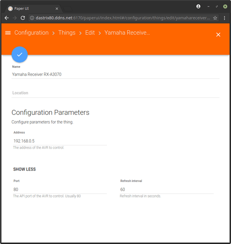

Unfortunately, this version introduces host/port/zone config naming changes, so it will require to remove the thing and add it again (via paperUI) or changing the .thing file.
I am experiencing problems with this binding after upgrading to SNAPSHOT-2.3.0.201805091233. Prior to this, I was successfully using the binding with my Yamaha HTR-4065. It appears that discovery found my receiver, but in the YamahaZoneThingHandler method isCorrectlyInitialized(), the binding throws an NPE:
2018-05-13 14:37:57.468 [DEBUG] [.internal.protocol.xml.XMLConnection] - Making POST to http://192.168.1.201:80/YamahaRemoteControl/ctrl with payload: <?xml version="1.0" encoding="utf-8"?><YAMAHA_AV cmd="GET"><System><Config>GetParam</Config></System></YAMAHA_AV>
2018-05-13 14:37:57.614 [DEBUG] [.internal.protocol.xml.XMLConnection] - Making GET to http://192.168.1.201:80/YamahaRemoteControl/desc.xml
2018-05-13 14:37:57.952 [DEBUG] [nal.protocol.xml.DeviceDescriptorXML] - Retrieved descriptor from /YamahaRemoteControl/desc.xml
2018-05-13 14:37:58.222 [DEBUG] [nal.protocol.xml.DeviceDescriptorXML] - Found system 1, zones 1, features 4
2018-05-13 14:37:58.245 [DEBUG] [.internal.protocol.xml.XMLConnection] - Making POST to http://192.168.1.201:80/YamahaRemoteControl/ctrl with payload: <?xml version="1.0" encoding="utf-8"?><YAMAHA_AV cmd="GET"><Main_Zone><Basic_Status>GetParam</Basic_Status></Main_Zone></YAMAHA_AV>
2018-05-13 14:37:58.330 [INFO ] [al.protocol.xml.DeviceInformationXML] - Found zones: [Main_Zone], features: [AIRPLAY, NET_RADIO, TUNER, USB]
2018-05-13 14:37:58.388 [DEBUG] [.internal.protocol.xml.XMLConnection] - Making POST to http://192.168.1.201:80/YamahaRemoteControl/ctrl with payload: <?xml version="1.0" encoding="utf-8"?><YAMAHA_AV cmd="GET"><Main_Zone><Input><Input_Sel_Item>GetParam</Input_Sel_Item></Input></Main_Zone></YAMAHA_AV>
2018-05-13 14:38:00.075 [DEBUG] [.internal.protocol.xml.XMLConnection] - Making POST to http://192.168.1.201:80/YamahaRemoteControl/ctrl with payload: <?xml version="1.0" encoding="utf-8"?><YAMAHA_AV cmd="GET"><System><Power_Control>GetParam</Power_Control></System></YAMAHA_AV>
2018-05-13 14:38:00.132 [WARN ] [mmon.WrappedScheduledExecutorService] - Scheduled runnable ended with an exception

Good day to everybody.
I set up Yamaha RX 3070 now and expecting problem with HDMI outputs. Can’t guess what names they should have and can’t find “PaperUI > Configuration > Things > Edit > Yamaha Receiver XXX > Input mapping” in my OpenHAB.
Can anybody help?
P.s. “AirPlay” has problems too. And surroundings almost not working at all: after switching to options surrounding returns back.
desc.xml (206.2 KB)
What version of OH and the YamahaReceiver Addon are you using?
Please post your .items and .sitemap relevant config fragments for input and surround.
Note that only since 2.3.0 the addon has this input mapping (or in 2.3.0-SNAPSHOT in my link above). Also improvements to the HDMI issues reported by users were introduced. Therefore the input mapping should be considered rather last resort.
I use 2.2.0. Can be plugin updated separately?
