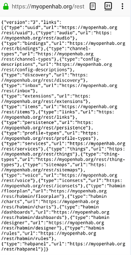

  1. Can you log into https://myopenhab.org/rest using a web browser on your Android phone?

Please be more specific. When you go to the URL, are you able to enter a username/password and then you’re denied? Or are you not even able to access the URL in the first place?
I was suggesting that you install the “openHAB Beta” Android app from the Play Store. Sorry, that wasn’t clear on my part.
That being said, if you can’t access myopenhab.org/rest from a browser on your Android phone, then I don’t think the app is the problem.

  1. I have acces to https://myopenhab.org/rest from my android browser.
