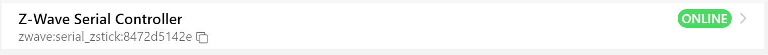

I connected a new Z-Stick Gen5 (well, bought a while back; just now getting around to hooking it up) to a new (really brand new) RPI 4 running openHabian. I added the Z-Wave Serial Controller bridge, which looks like it was successful (it shows online).
However, it does not find any devices when searching. I have two unattached devices that it should find. These show up on OH2’s inbox when I scan there.
