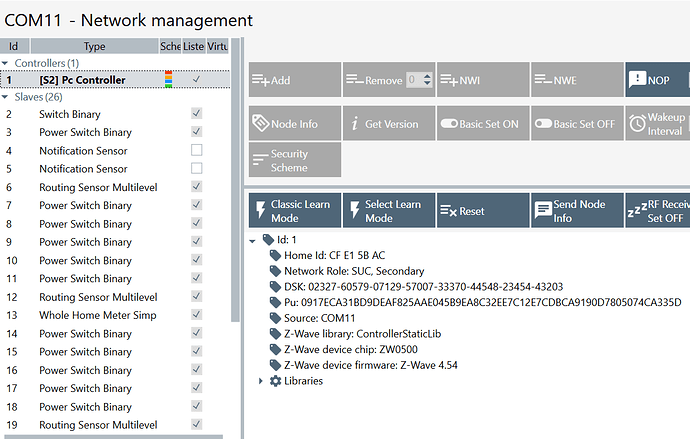

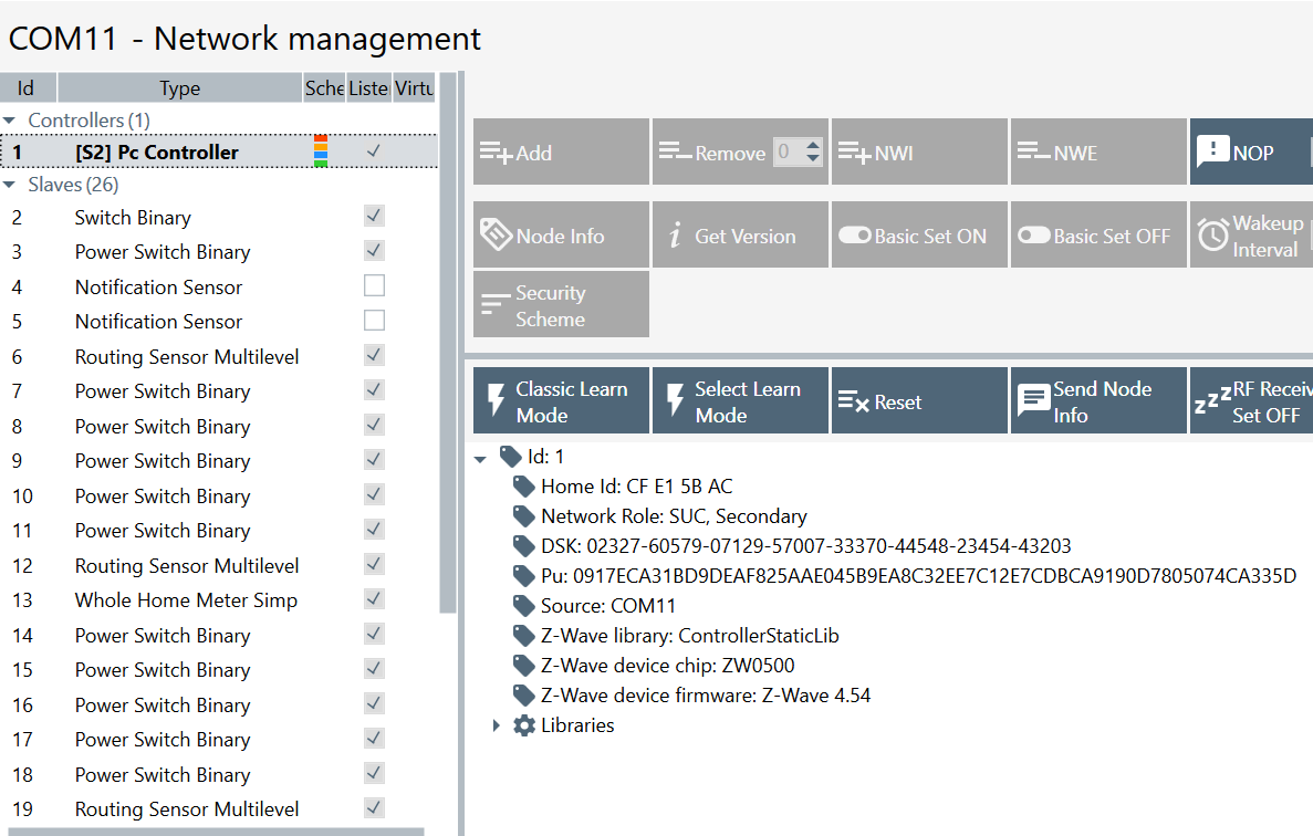

I’ll get a screenshot of what I see in Z-Wave PC Controller. I’m pretty sure there’s only one entry in the “controllers” section. Presumably none of the devices in the “slaves” list can be controllers?
All the slave nodes are the devices I added. And apparently there’s just one controller. The Zipabox is turned off right now, but even if I turn it on it doesn’t appear in the network.

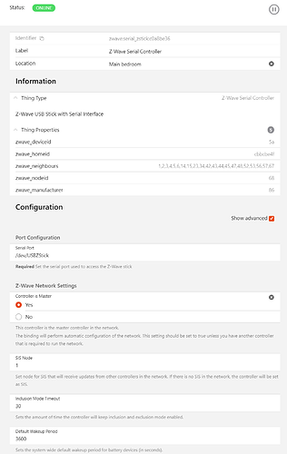

I found something anomalous. The Z-Wave Serial Controller thing, which I haven’t deleted and re-added, still says that the Z-Stick node ID is 68, which is no longer true. That was its old ID when it was the secondary to the Zipabox. I’ll delete it and try adding it again.

Deleting the Z-Stick serial controller and re-adding it changes the ID of the thing, so now I have to add all the Z-Wave devices again (they all reappeared in my inbox). I’m concerned that I’m going to add them all again, only to come up against the same problem and have to repeat the operation for a third time, having this time factory-reset the stick. Quite likely. Ah well, in the name of science…

The Z-Wave PC Controller still shows the Z-Stick as secondary.
It looks like you are well into it, so this may not help. When you first create the bridge (plus, zwave,manual-Bridge) you can edit the UID to use the previous value.
