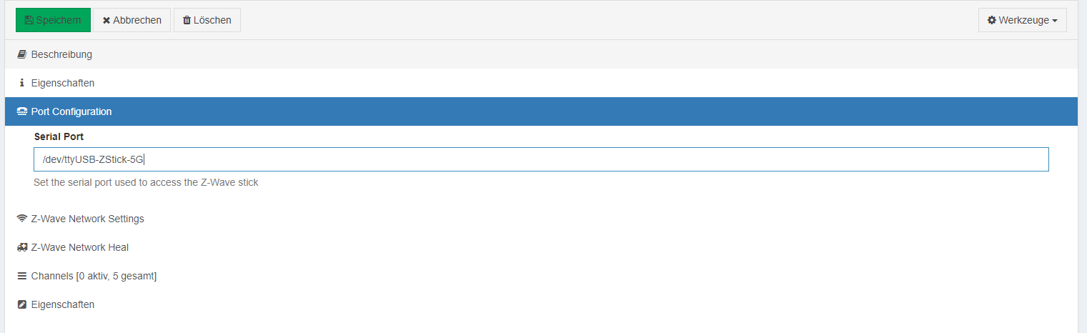

I suggest to add the following step after adding the symlink to PATH in Java, that is modifying the port of the Z-Wave Stick in HABMIN/Configuration/Things:
