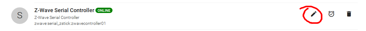

PS: When I edit Z-Wave controller to choose path, Arduino gets disconnected in same way. This is normal I guess and it was presented in previous revisions⌠But from 2.5.1 - 2.5.9 after choosing right /dev/path, all devices still reconnecting every 20 sec.
