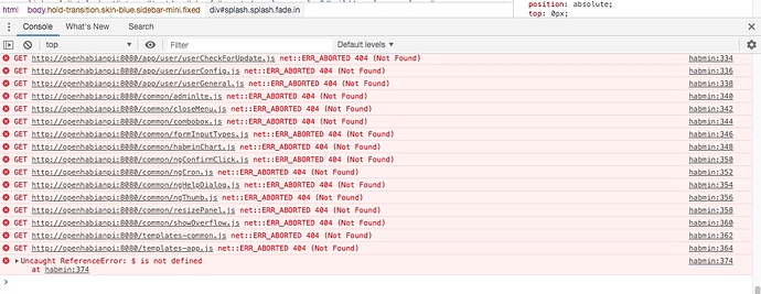

If I look into the browser log there are more than 300 ‘Not Found’ errors:
(Just took a screenshot of the last few errors)
I sure wish I had an answer, but I just joined to say that I’m having the same trouble. I couldn’t get anywhere by using HABmin either. One additional thing I noticed is that, as soon as the pi restarts, the Thing shows as online, then it switches to uninitialized, then to the missing handler error. I’m brand new to openHAB, so I don’t know where anything is yet. Maybe I’ll just start over from scratch and see what happens.
