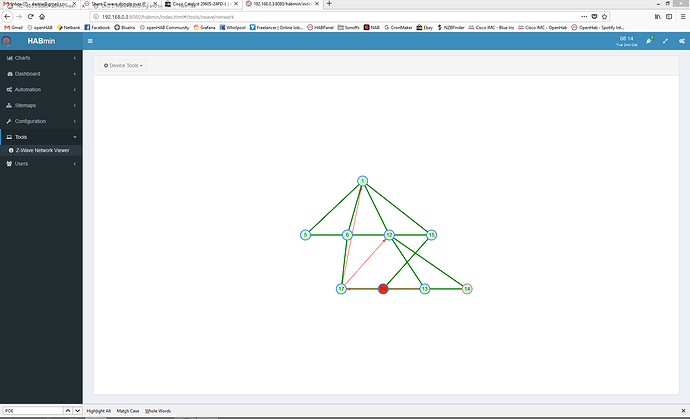

here is a diagram of my setup.
I have to move my router/oh2 server (Its a Cisco UCS blade inside a Cisco 3945 router) into the garage. In doing so, the OH2 server will be quite far from the Zwave devices in the house.
Currently the server/Zwave stick is in the house and operates the zwave devices just fine - including the Aeotec multisensor in the garage however the Aeotec Dimmer 2 just left of the Multisensor fails to operate reliabiliy. I suspect the Tree is blocking some of the signal.
I am proposing to have a zwave aeotec stick inside the house, connected to a Ubuntu media server ive got that will operate the existing 10-15 home zwave devices and then move the OH2 server up into the garage to operate the few devices up there.
The house/garage are connected via a redundant Single mode fibre at 10Gbit, inside the garage and house are Cisco Gigabit switches that all the devices are sitting on.
Node 17 is the Aeotec dimmer at the end of the house which is outside and sits under the Eave (roof overhang), Node 16 is the Aeotec Dimmer in the garage. Node 15 is the garage multisensor
