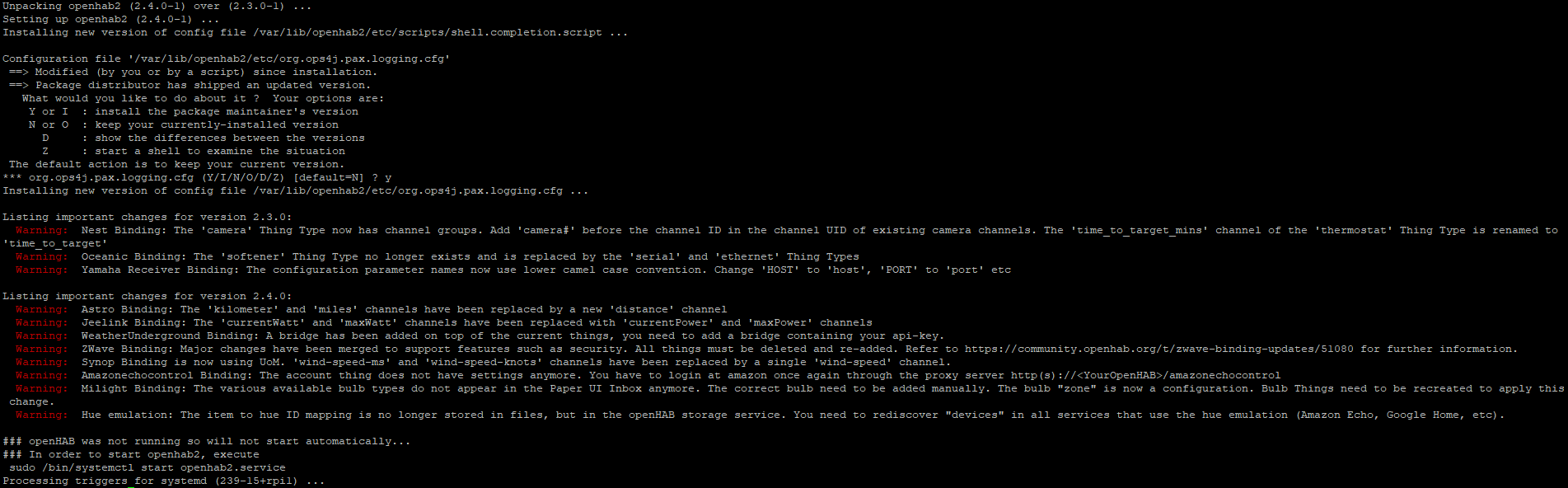

In one of the 2.4 milestones we had such a warning - the milestone after the Zwave change. So, it does seem to be possible. It’s not a popup as such, but then apt is not a GUI - it lists these changes, and I think the user has to press the Y button to accept them.
Unfortunately, we didn’t it seems flow these changes through to the 2.4 release. In future we need to try and ensure that the final release versions get this sort of information and not just have it in the milestones…
The alert that we had was the following -:
ALERT;ZWave Binding: Major changes have been merged to support features such as security. All things must be deleted and re-added. Refer to https://community.openhab.org/t/zwave-binding-updates/51080 for further information.
Apt will still display the list of breaking changes, but after the installation has taken place, the message for ZWave should have been there:
