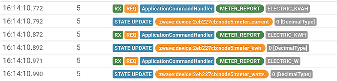

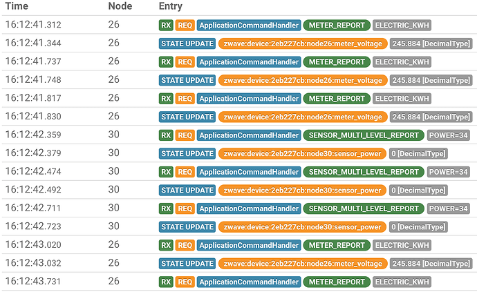

The above is a short part of the log - this shows that most messages are received multiple times - this happens from multiple devices as well. This will likely be causing problems with the general operation of the network and can be caused by a couple of things -:
incorrect configuration of associations. If you have configured devices to send the same information to the controller in multiple groups, then you’ll see this. For newer devices, only the lifeline is required.
Problems with the network. If the response from the controller is not making it back to the devices to say that the message is received, the device will resend it. This can really congest the network.
This may or may not be contributing to the issue with this device, but it certainly won’t be helping.

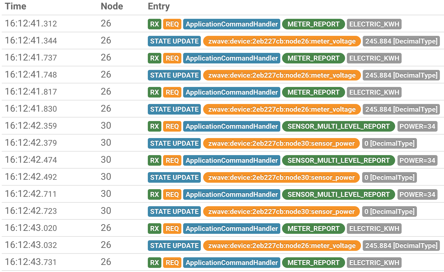

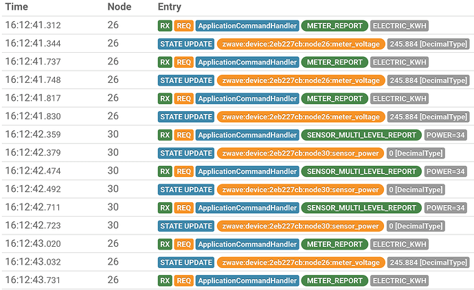

Both nodes 26 and 30 are quite far from the controller (probably the farthest), which possibly could cause the high traffic - also those are power plugs which report very often their state (30s). On the other hand, everything seems to be working well from perspective of the user.

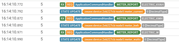

It shouldn’t though. There is something wrong here and I would really suggest it should be fixed or I think you will have problems. Everything is being received many times from these devices - note that is also happens with node 5.
Node 5 is another power socket. Do you have any suggestions how to diagnose the problem? This node also has no other associations other than lifeline with the controller.
It’s not super easy to diagnose with a sniffer. I would probably suggest to see if there is an “obvious” common point between these three nodes for starters. Eg does it look like they might all route through one device, and then is that device maybe a little too far from the controller? Place a mains device in this gap to see if it helps - it might be a bit of trial and error…
My guess is that somewhere along the route, the ACK isn’t being received by one of the devices, so the preceding device is sending a retry, which is also not being acked. This repeats a few times and it either gets the response or gives up, so the retries stop. If so, it also likely means that commands from the controller to these devices might also be living on the edge and could also be unreliable.
