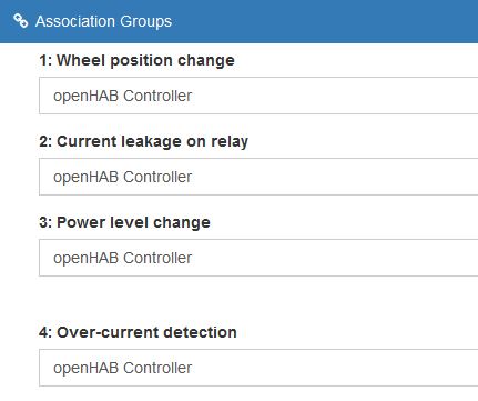

Are the associations configured?
I set all 4 to “openHAB Controller”, however i dont know if this save correctly. After Save and reopen it, ther is nothing in the setting tab. Is there any tool to view the associations groups, or the only way is to open the thing properties?
I would check in Habmin, but they could also be found in the Things jsondb. If they are disappearing from PaperUI, then something sounds amiss. Are there any errors in the log (esp. for the zwave binding)? Which version of the binding are you using?
I see no error by changing the associations group in Habmin. Also i found no Error for binding. The inklution will work realy fast and without problems. I dont think its a problem with the defice. Today evening i can reinclude my KFOB-C and have a look to the log File. Currently i not @home so i only have remote access.
