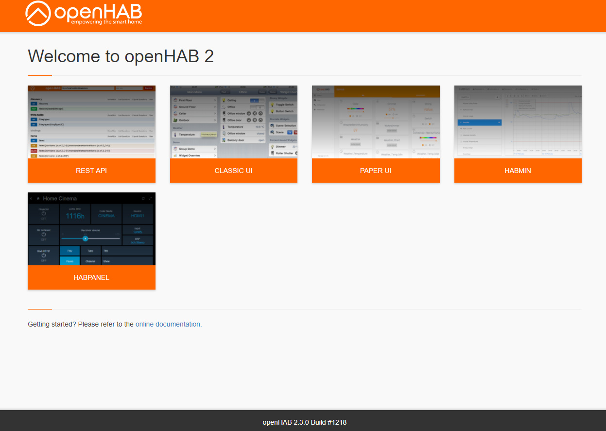

The easiest place is on the dashboard, but maybe that was added in a version newer than yours.
You can also find it in the Karaf console.
