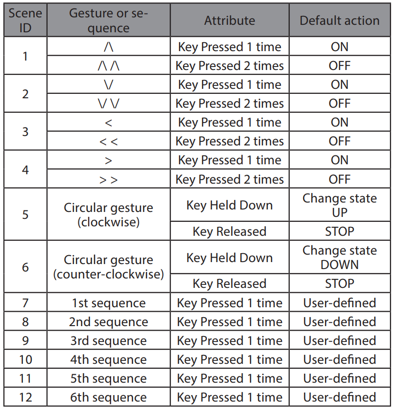

Actually it only has one channel for swiping: scene_number
grafik
So you need to find out the different scene numbers for different swipes and use them in rules.
Edit: page 11 of the manual lists them:
