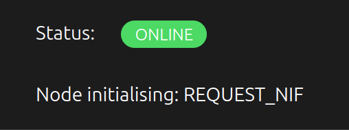

When I restart OH 5.0.3, the thing is still ONLINE…

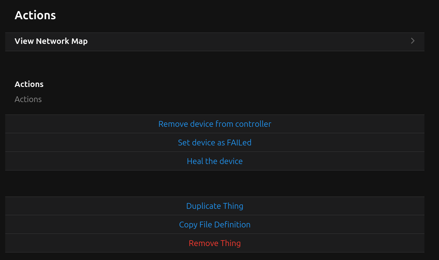

And I see these actions:
Should I use the “Set devices as FAILed” ?
I see no action to remove failed devices.
What are the actions on the controller UI? Those are preferred
Edit: you could try to first set device as failed, then once the ui shows failed, then try the remove device
