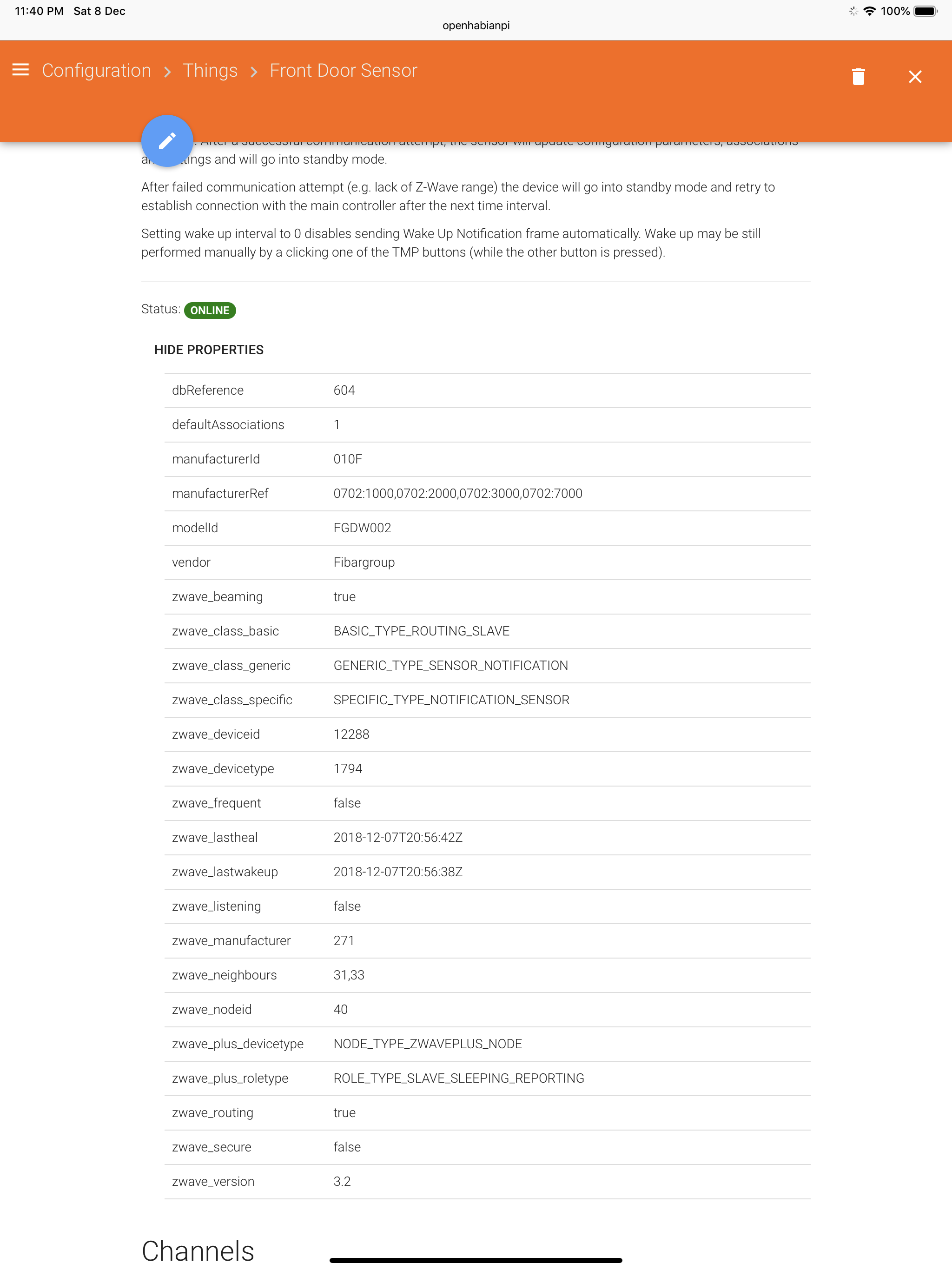

the fibaro door sensor as I open and close the door, I’ve set it up with the parameter to flash the blue led when it detects an open or close event which it did
