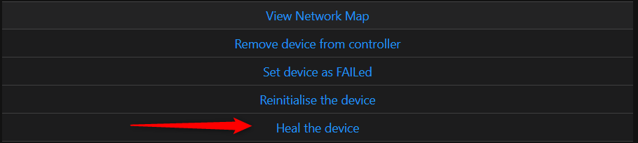

I have had some network changes recently. Some of z-wave devices were removed, new included.
To make an efficient routing and reaction time I was wondering to re-order the communication.
I understand the “Heal Device” makes re-routing for the particular thing
Is there any possibility to initiate efficient re-routing for all devices?
Is it happening after system restart?
How to ensure solid and efficient z-wave communication if some devices changed their position?
