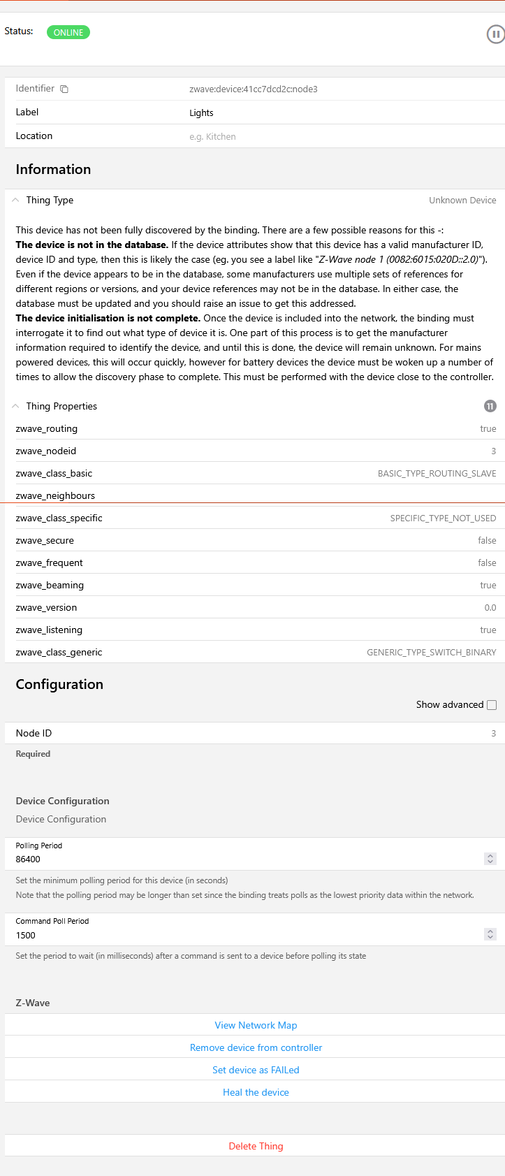

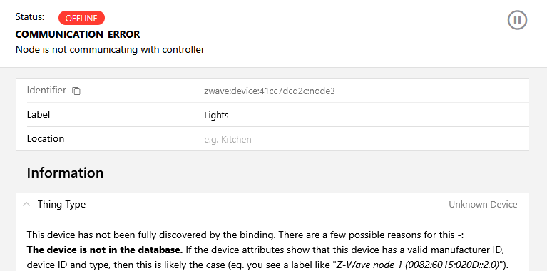

Z-Wave - 'Not initialized (ie node unknown), ignoring message.' - Heatit ZM Relay Single Relay 16A
I have a Z-Wave Heatit ZM Relay Single Relay 16A that suddenly stops working correctly and this means no more hot water. :cold_face:

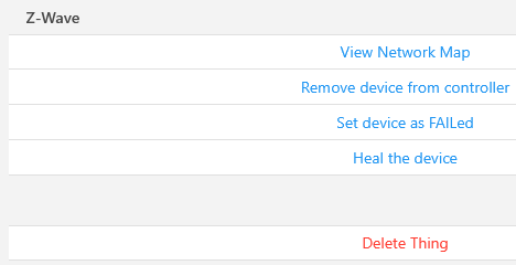

You could try to reinitialize the device, if that option shows on the Heatit UI page. Also what controller are you using. OH4.0 only supports the older ones. Also don’t know if the HttpChannel NPE is related. ZW doesn’t use that AFAIK. If that didn’t go away on a restart it might be more than a fleeting issue. Sorry can’t help more.
I just have these options :neutral_face: :
I have an Aeotec Gen5. The “rest”, except another similar device that also has some connectivity issues that I will need to have a look at.:smirking_face:
Well, when all else fails, try to remove the device and reinclude. Before you reinclude, set the ZW binding to debug. Unfortunately, in OH4.0 I think that requires going into karaf console. log:set DEBUG org.openhab.binding.zwave then go back to INFO

I tried with the other relay of same type, and this is what I get when I try to add it:
2026-01-07 00:59:47.509 \[DEBUG\] \[ding.zwave.handler.ZWaveThingHandler\] - Initializing ZWave thing handler zwave:device:41cc7dcd2c:node3.
2026-01-07 00:59:47.512 \[DEBUG\] \[ding.zwave.handler.ZWaveThingHandler\] - NODE 3: MANUFACTURER not set
2026-01-07 00:59:47.513 \[DEBUG\] \[ding.zwave.handler.ZWaveThingHandler\] - NODE 3: Controller status changed to ONLINE.
2026-01-07 00:59:47.514 \[DEBUG\] \[ding.zwave.handler.ZWaveThingHandler\] - NODE 3: Controller is ONLINE. Starting device initialisation.
2026-01-07 00:59:47.518 \[DEBUG\] \[ding.zwave.handler.ZWaveThingHandler\] - NODE 3: Updating node properties.
2026-01-07 00:59:47.521 \[DEBUG\] \[ding.zwave.handler.ZWaveThingHandler\] - NODE 3: Updating node properties. MAN=2147483647
2026-01-07 00:59:47.523 \[DEBUG\] \[ding.zwave.handler.ZWaveThingHandler\] - NODE 3: Properties synchronised
2026-01-07 00:59:47.526 \[DEBUG\] \[ve.internal.protocol.ZWaveController\] - Event listener added.
2026-01-07 00:59:47.527 \[DEBUG\] \[ding.zwave.handler.ZWaveThingHandler\] - NODE 3: Initialising Thing Node
2026-01-07 00:59:47.528 \[DEBUG\] \[ding.zwave.handler.ZWaveThingHandler\] - NODE 3: Polling initialised at 86400 seconds - start in 59702400 milliseconds.
2026-01-07 00:59:47.530 \[DEBUG\] \[ding.zwave.handler.ZWaveThingHandler\] - NODE 3: Device initialisation complete.
2026-01-07 00:59:48.813 \[DEBUG\] \[WaveSerialHandler$ZWaveReceiveThread\] - Receive Message = 01 10 00 04 10 06 0A 60 0D 03 01 31 05 01 22 00 00 8F
2026-01-07 00:59:48.815 \[DEBUG\] \[nal.protocol.ZWaveTransactionManager\] - processReceiveMessage input 0<>128 : Message: class=ApplicationCommandHandler\[4\], type=Request\[0\], dest=6, callback=16, payload=10 06 0A 60 0D 03 01 31 05 01 22 00 00
2026-01-07 00:59:48.815 \[DEBUG\] \[nal.protocol.ZWaveTransactionManager\] - Received msg (0): Message: class=ApplicationCommandHandler\[4\], type=Request\[0\], dest=6, callback=16, payload=10 06 0A 60 0D 03 01 31 05 01 22 00 00
2026-01-07 00:59:48.816 \[DEBUG\] \[nal.protocol.ZWaveTransactionManager\] - lastTransaction null
I can not create any equipment from device, as there is no channel listed (and as indicated, the manufacturer can not be fetched). :roll_eyes:
Then the Thing changed to:

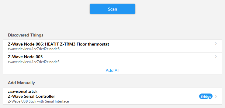

That doesn’t look like an add. Did you exclude it first? It should be a new number
Yes, I excluded
 then the device appeared in the list as new device after I requested a scan (trying also to get a floor thermostat removed). :neutral_face:
A few minutes later
 I got this picture.

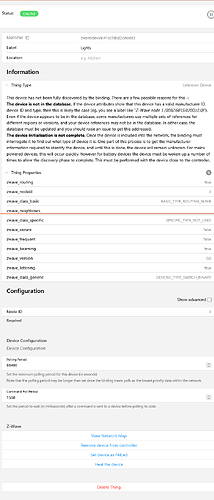

Edit: and then
 back again to the node 3 without device description
I am very confused with what is happening. :neutral_face:
