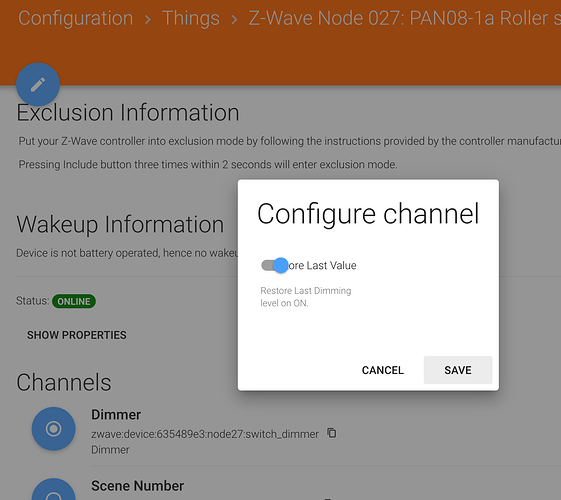

After upgrading to OH2.4 and re-adding all the things according to the instructions I also had to reconfigure inversion settings for some roller shutters. This worked for all other roller shutters except for the PAN08-1a type, which does not provide a blinds_control channel but a switch_dimmer instead. For this channel, no inversion settings are available, so this shutter opens fully at 100% and closes at 0%. Is there any other way to invert percentages and control as for blinds_control channels?
Strangely, I had a working blinds_control channel for one of my two PAN08-1a in my .items file before the update. The other one (which is mounted in the “right” orientation and does not need to be inverted) already was a switch_dimmer. Maybe they have been initialized with different XML definition files.
The invert option is only available for rollershutter type items.
