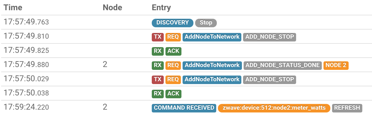

I removed the “thing” and added it again, whilst capturing a DEBUG log. It looks like it’s discovered and added and initialized fine. But I see no values updating. And hwen I send a manual refresh this happens:
This simply means that the device is not initialised, and until the initialisation is complete, it won’t perform the polling.
There’s next to nothing in the log, so I can’t comment much more - there is no communication at all between the device and the controller, so maybe you should exclude the device and re-include it in case there was an issue with the controller during inclusion.
I had assumed that the initialisation does complete successfully. And shouldn’t the fact that I can send on / off commands also mean that it is initialised or is that a red herring?
It’s very hard to know what is happening. As I said, there’s very little in the log and it only lasts about 2 seconds. There is no communications with the device, and I don’t really know what state anything is in.
Possibly this is true, but not necessarily. But here you have more information than me as the log doesn’t have any of this either.
Yes, there is a message received here, but this message comes from the controller, not the device itself.
Aaah right, ok. Apologies. I did not realize that this was only messages between the controller and binding, rather than the device itself.
