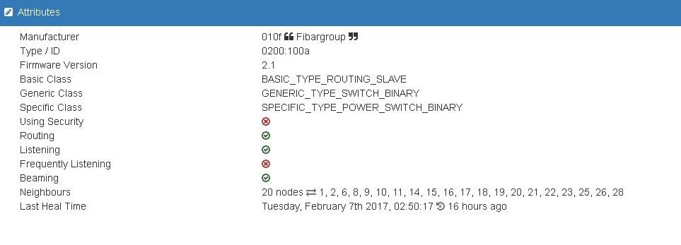

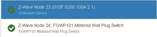

I’m actually having the same issue with many of my fibaro relays as well, they show up as unknown devices although their id, type and version seem known … I’ve tried restarts of the docker container, and multiple deletes and rediscovers… I’ll let things run the night through and see what happens…

The fgs221 from Fibaro show up as unknown. (the fgs211 however show up fine). Previously they have been detected properly!
They are listed here, and all the attributes seem to match: http://www.cd-jackson.com/index.php/zwave/zwave-device-database/zwave-device-list/devicesummary/121
I don’t think that’s correct -:
This one should be ok though -:
http://www.cd-jackson.com/index.php/zwave/zwave-device-database/zwave-device-list/devicesummary/123
Sorry
