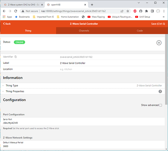

The 10 digit hex string in the z-wave controller’s Thing Identifier (“39d51d11b2” in the example below) must match the value in the channel parameter of the .items file. This can be done either by changing the controller’s Identifier to match what is in the .items file when creating the controller’s Thing or by doing a mass change in the .items file.

If you didn’t follow each part of step 2, the Thing ID for the Controller and all the Zwave Things will be different from before. That means the links will no longer be valid between the Channels and the Items. You’ll need to recreate those Links or recreate all the Zwave Things using the same Thing ID as you had before.
See, that’s the thing - I did all steps except security since no security has been applied to OH2 and the Stick. And I did change the Stick ID in openHAB to be the same as on the stick.

This doesn’t make sense to me. What Stick ID that’s the same as on the stick? The ID I’m talking about is the Thing ID which frankly has nothing to do with the zwave controller stick.
That needs to be the same as it was on the old system or else all the openHAB Things will have a different ID and the Links to your Items will be invalid.
Or you can just relink the Channels to the Items with the new ID, though that’s more work.
