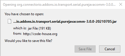

You might have downloaded the wrong file. It should be this one:
Thanks, in here might be also lack of knowledge on my side but behind the link “org.connectorio.addons.io.transport.serial.purejavacomm-3.0.0-20210705.jar” a blank page is shown. I can not see any file… any idea?
Hi, when I click on the link there is a download shown. This you need:
Maybe you have to check Pop-Up-Blocker, etc..
Used Edge instead of Chrome and it worked :pray: thanks a lot for the support.
