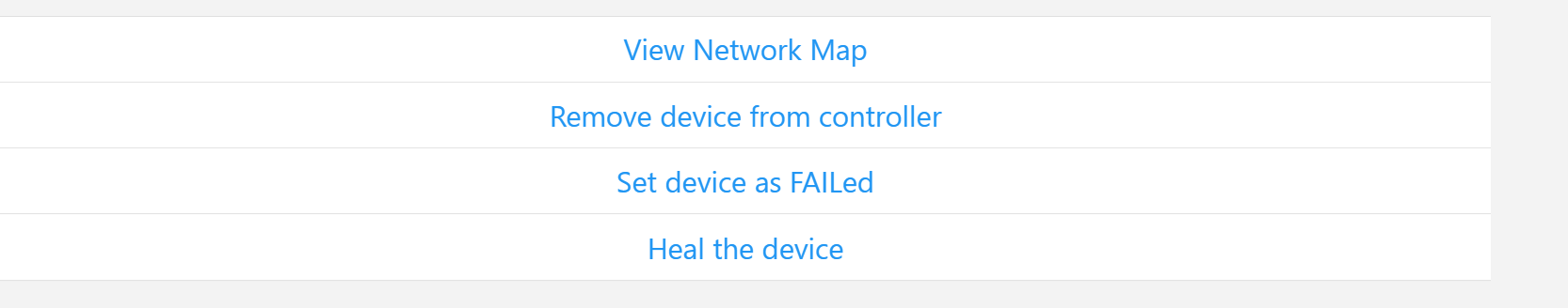

Not a lot to go on, but did Node21 fully get included? Are there 5 five lines on the Node 21 UI page?

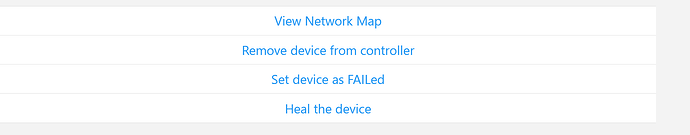

Thanks Bob, So I’m missing the reinitialise line:
