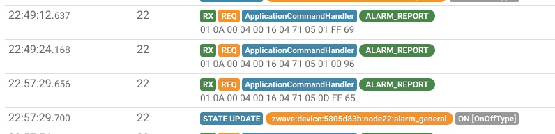

I spent a little time tinkering tonight and got it running with the latest snapshot. I put the z-wave binding in debugging mode, and captured some data while setting the smoke alarm off with actual smoke and then I set it off using the test button.
I triggered it with smoke around 22:49:12 and I triggered it with the test button around 22:57:29. It is node 22. There is a bunch of junk in there for other nodes. If needed, I can disable the other nodes so it doesn’t clutter up the log. Also, I can trigger it with CO and send the log. I really suspect the alarm makes a distinction between being triggered from smoke, CO, and the test button.

I take back what I said. It actually appears to be the opposite of what I said.
SMOKE is not causing an update to the alarm channel. This is generated by the detection of real smoke.
HOME_HEALTH is causing an update to alarm_general (see log viewer above at 22:57:29.700 immediately after the receipt of the HOME_HEALTH alarm type). This is generated by the device when the test button is pressed.
So,
real smoke causes alarm type SMOKE and does not update the alarm_general channel (see 22:49:12.637)
test button causes alarm type HOME_HEALTH and updates the alarm_general channel (see 22:57:29.656)
This is consistent with what was reported in the first post.
