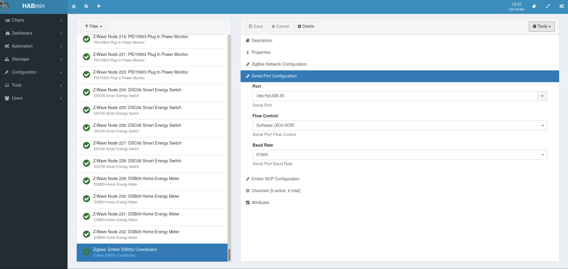

You configure the controller/coordinator Thing. I prefer using Habmin…
