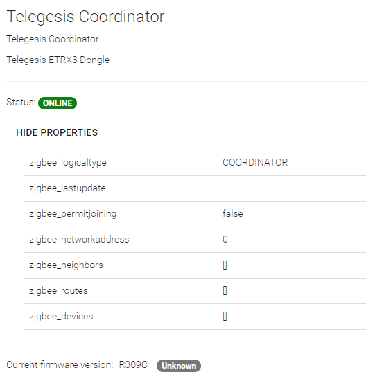

Hi @chris, Played around with my ETRX3 today to try and get it to replace my HUE bridge, I’m on R309C firmware but the binding doesn’t recognise it:
I’ve unpaired one of the hue bulbs using the touchlink command on the Hue bridge, but still can’t get the binding to find anything. The debug logs for the binding as soon as I add the coordinator as a thing are:

It shows ONLINE in your image - I think the binding does recognise it.

When you say join mode, that’s done by searching for things right? I’ve set “Allow All Joins” and still no dice. I’m a little baffled at why zigbee_permitjoining is always false too.

Correct.
Ignore this - it’s a status feedback from the beacons that is only updated during the mesh update.
