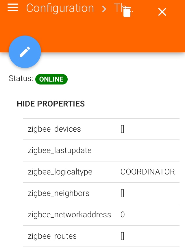

The config of the stick thing looks a bit weird in PaperUI
In the thing text config I have this:
Thing zigbee:coordinator_cc2531:stick1 "Zigbee USB Stick" [zigbee_port="/dev/ttyACM0", zigbee_baud=38400, zigbee_panid=35637, zigbee_extendedpanid="118E309DE90CC829", zigbee_networkkey="14 c6 a2 c7 fb e0 c3 19 8e 7c 36 30 dc ad a5 96"]

What is weird? It looks ok to me I think?

I am just confused because there is no networkaddress for example.
